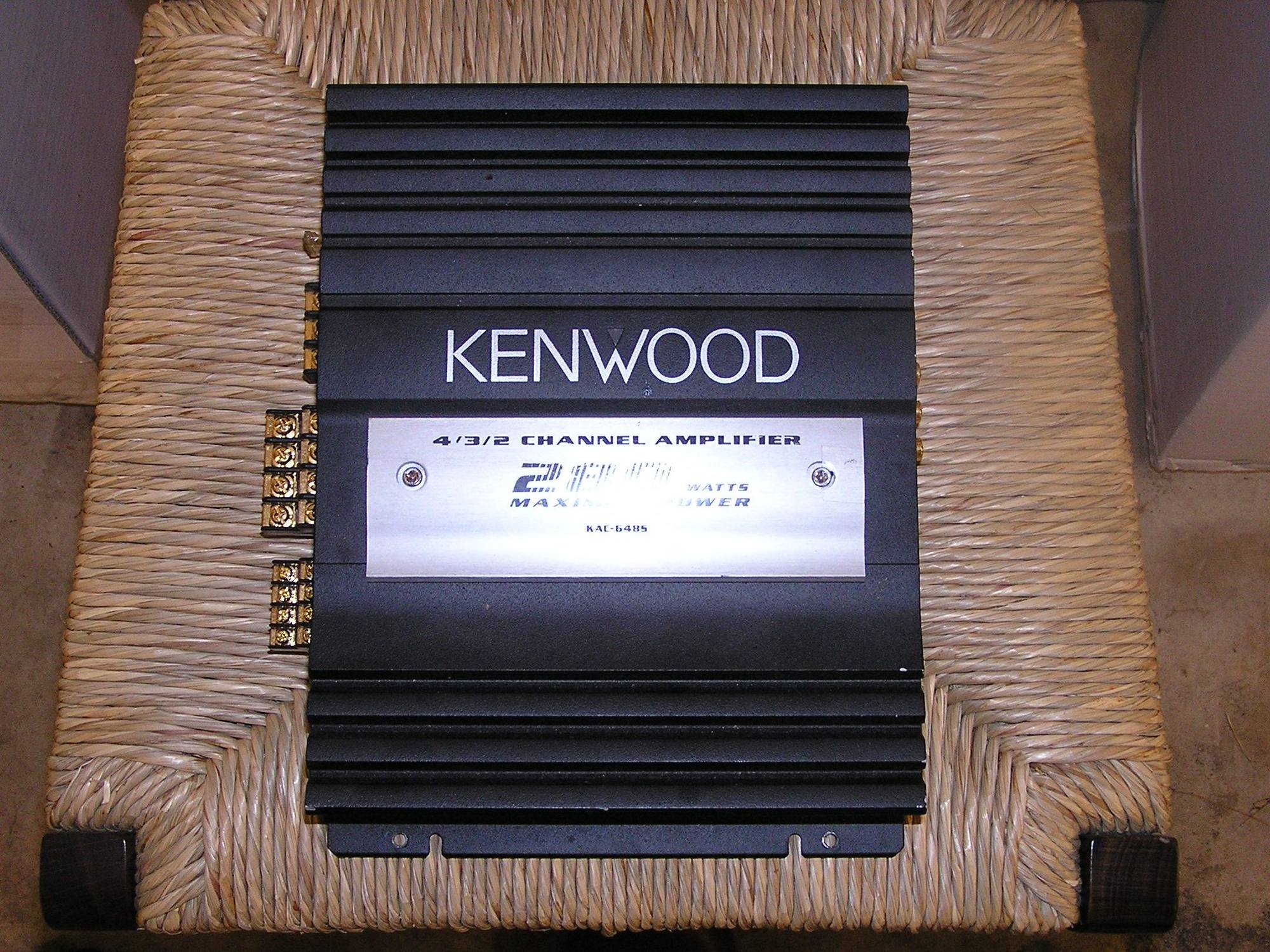

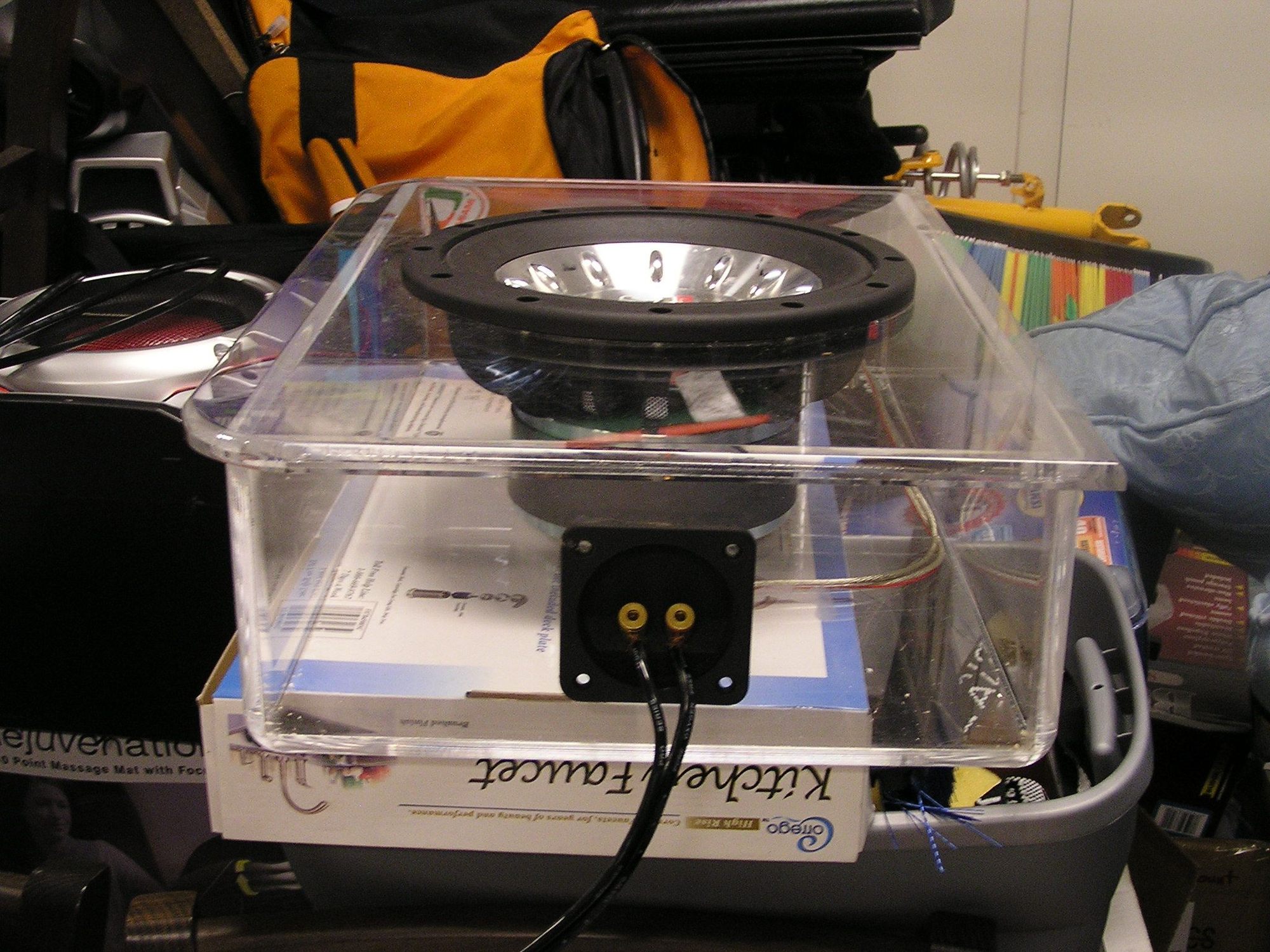

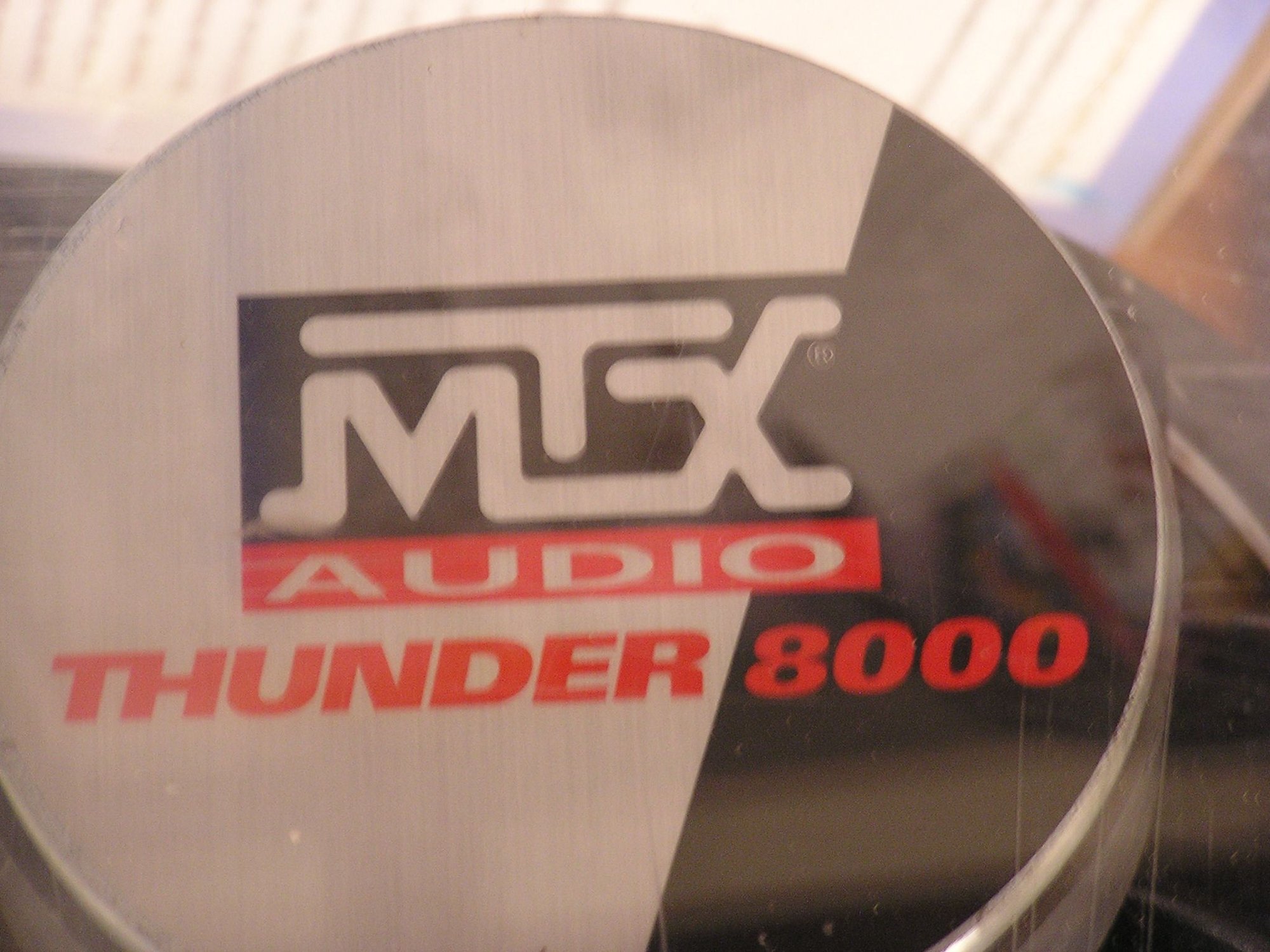

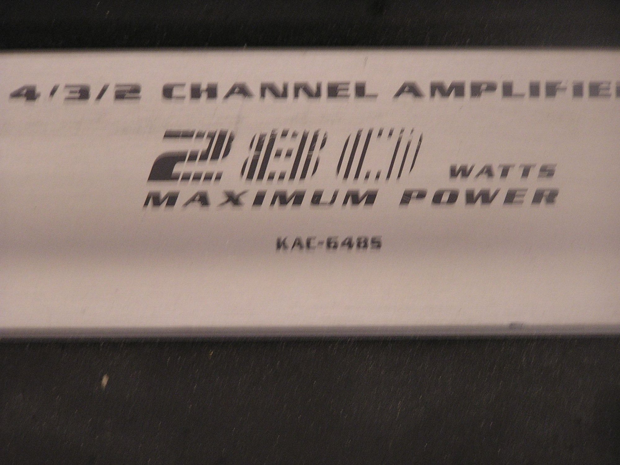

I have a MTX8000 and a Kenwood Amp model KAC-6485 4/3/2 Channel 280 watts that I acquired through a previous purchase and would like to use

i know very little about that subwoofer, so i'm not quite sure what to tell you about it. do you have a manual or stats on it? that may help the installer as they make choices regarding the sub.

1. i'm not finding much information on that amp. but let's go w/ what we know and what is typical for marketing... 280 Watts peak.
generally, that means you have 140 Watts RMS. now, that's for a 4 channel amp. given that they usually measure wattage for marketing labels when the amp is fully loaded, that means you've got roughly 70 W RMS x 2 channels @ 4 ohms when bridged. breaking that down further gives you 18 W RMS x 4 channels @ 4 ohms.
not exactly a powerhouse of an amp. i know you may not follow my numbers, but i'll quickly try to explain them. peak power is usually 2 times continuous power. (280 W/2 = 140 Wrms) now, this is a 4 channel amp that can bridge to 2 channels (which is it's peak output configuration. so 140 Wrms / 2 = 70 Wrms.) now when you bridge 2 channels, you quadruple the power. (so 70 Wrms / 4 = 17.5 Wrms which is about 18 Wrms.)
in summary -- you might want consider something making a bit more power to drive your front speakers, especially if you intend to drive the sub with the same amp. in fact, you might consider forgoing rear speakers for now and using those funds for a more powerful amplifier. something on the order of 75 Wrms to 100 Wrms would be suitable for the SL60's
