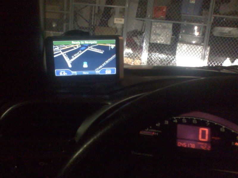

I received a Garmin Nuvi 200W for my birthday, and I decided to just use the suction cup windshield mount, as it's 1) free 2) easy 3) free and 4) easily removeable. I have it mounted allll the way to the left of the windshield like so:
Garmin doesn't offer a hardwire kit. I've seen some on the internet, are they any good? Has anyone used one? I imagine it will be REAL easy to run the wires because of the location.
