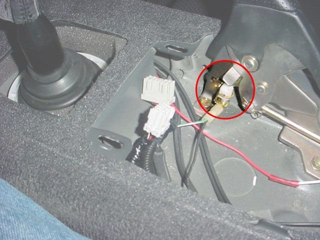

It's your e-brake sensor. it needs to be engaged for you to raise or lower your top. You can find it if you take off your center console. and look by your e-brake. It's a simple device that opens a circuit when your e-brake is engaged, it's not working. It sould be a simple fix unless the alarm has something to do with it.
here's a pic of it:
