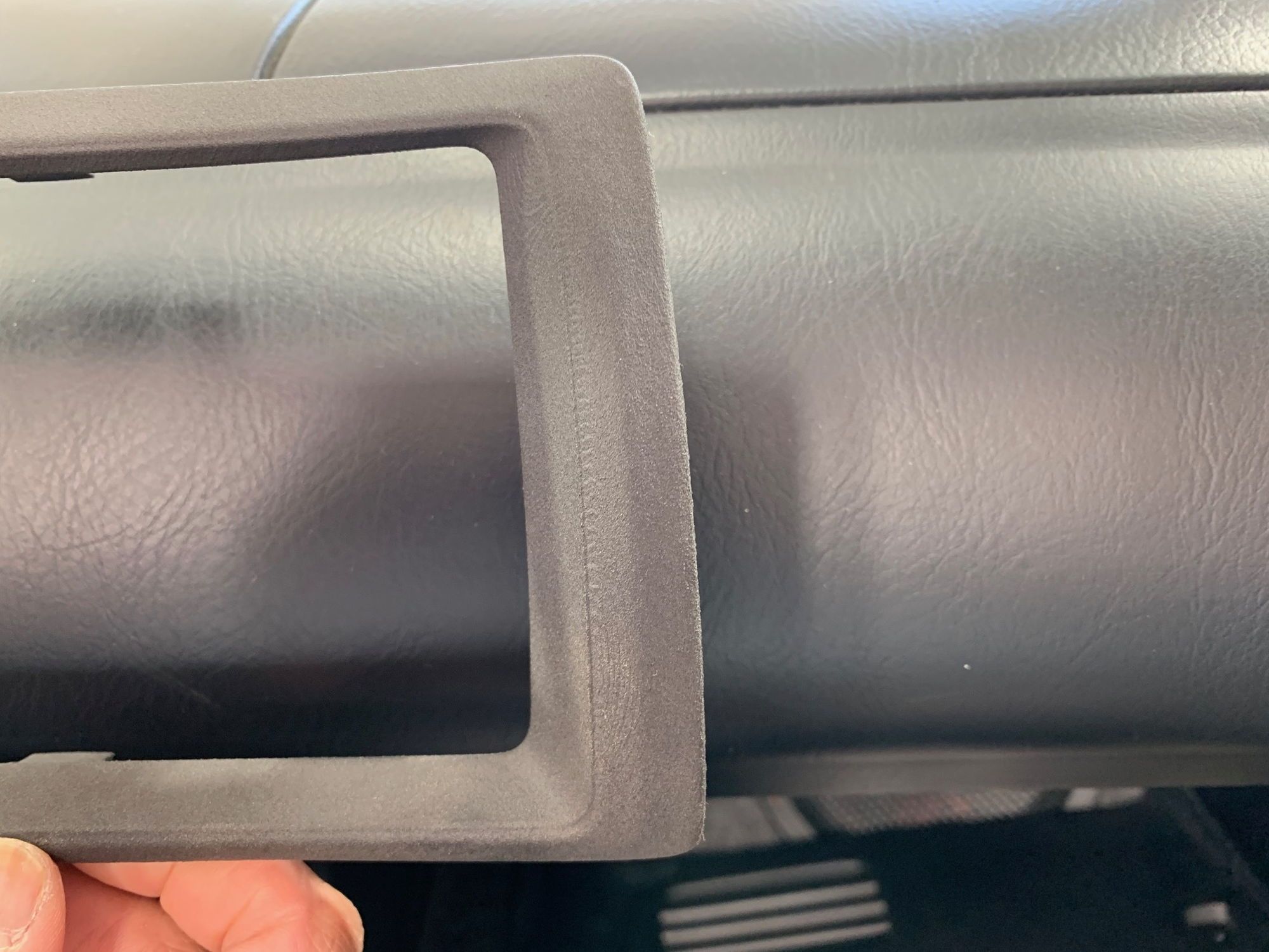

Update with some prototype production units. Unfortunately, my 3D printer source didn't identify which was printed with which technology, and I'm very new and haven't seen the differences before. So my best guess is the first couplee pics are of MJF. These are made from Nylon 12 and should be heat resistant to anything the car will see. It doesn't have the UV resistance that ASA has though.
Here is what I suspect is SLS
Here are close ups of the MJF
I'm still waiting on the ASA bezel sample. I'll update when it arrives. I welcome any thoughts on the samples so far.

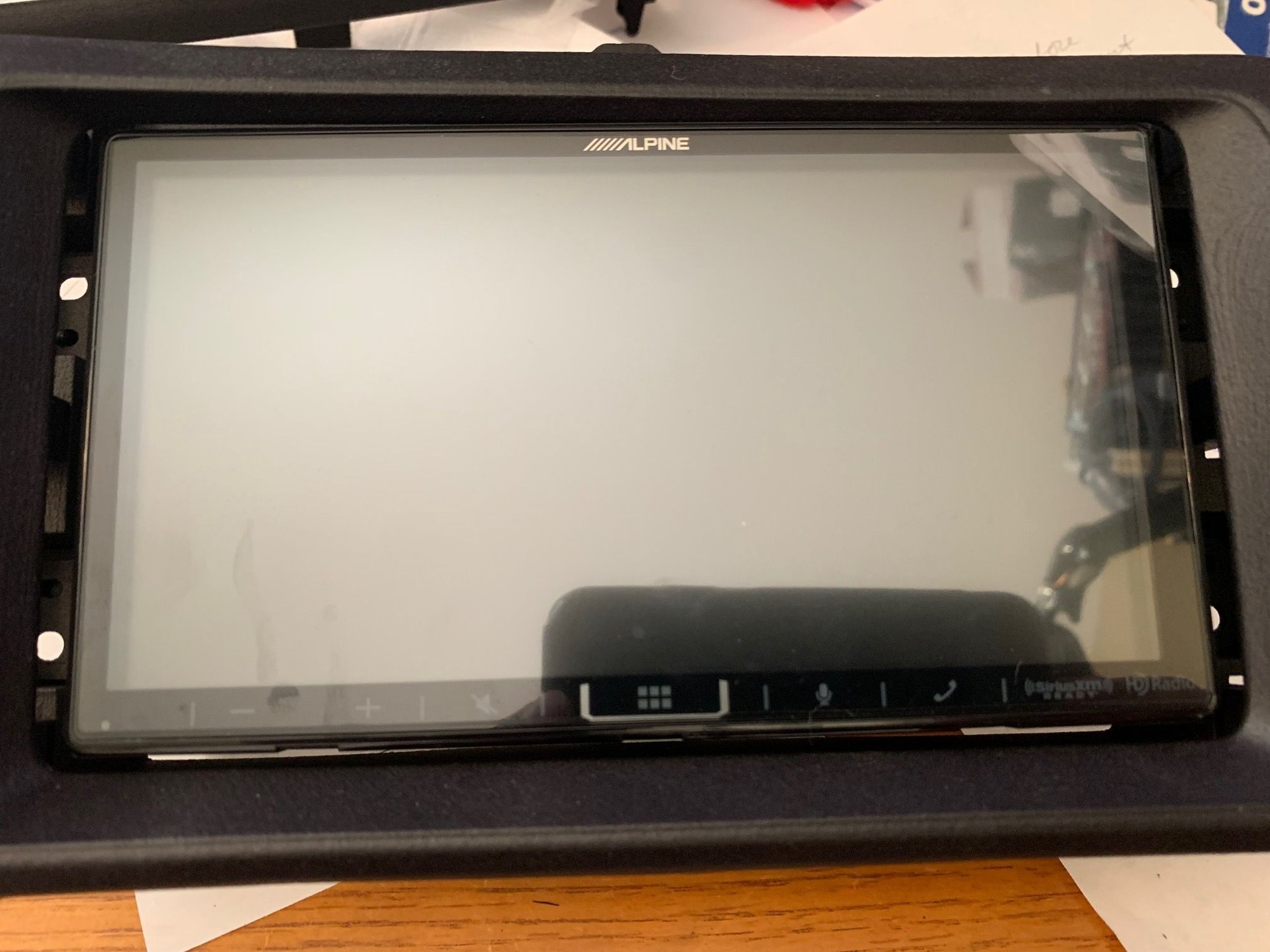

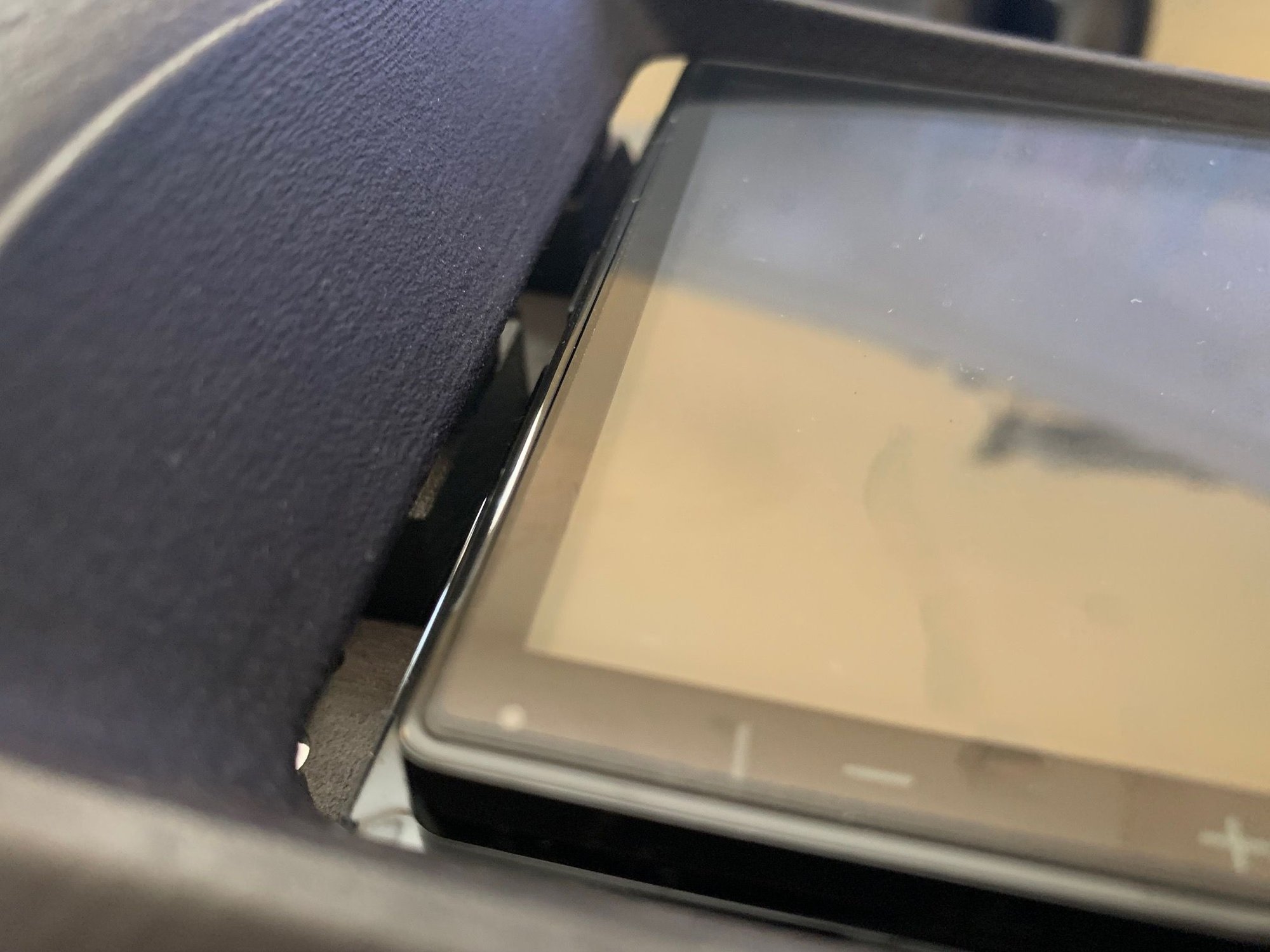

Another update. Here are the results of the test fit with all 3D printed parts:
I like the spacing from the ILX to the bezel up top. Obviously the bottom and sides need some work. I'm going to close up the other 3 sides for a better fit around the head unit. The amount the head unit is recessed also is an issue. If I recess the headunit another 1mm back, there will be a small gap in the upper left corner but will look much better in the other 3 corners.
