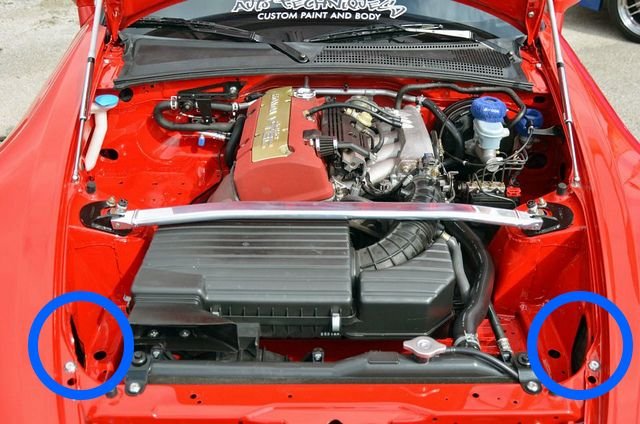

There is a 3rd way. If you've got flexible wrists, you can get to both the parking and turn signal lights from within the engine bay. That's how I upgraded to LEDs from JS2K.
Remove the airbox for the right side, and the coolant reservoir for the left side, and there are access holes on both sides. Keep your forearms parallel to the ground.
--Carlos V.

Obviously not a stock S2000 engine bay, but it was one I found on GIS that exposes the access holes I used. I annotated with circles.
--Carlos V.
