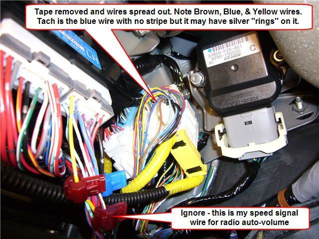

I was going to install a Modifry Shift Beeper in my 2008 but I can't seem to see the same wire that is shown in the manual for the tach signal
Looks like there are more wires in that area then in previous years. I would guess that the Tach wire is still there and I'm just not seeing it.

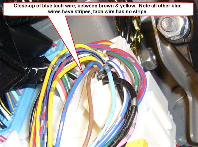

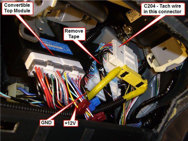

I'm lame. I've been meaning to update the instructions to include the '06-'08 models but never got around to it. Last weekend I took some photos of the wiring piece and hope to do the shelf removal process this weekend.
The '06-'08 wiring is actually easier than the earlier cars, here's the pictures to show you where to connect for the tach wire.
