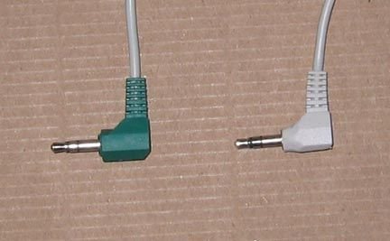

Check and make sure the stereo plug fits all the way into the radio. The first batch I made I shaved down some of the plastic around the plug to make them seat correctly.
For the second batch I got some slightly different plugs that seemd to fit without shaving, but I just tried some the other plugs in that order and it seems to be hit-and-miss as to which ones fit and which ones need trimming. So take a look at it, and if you have any doubts, you can use an emory board or razor knife to trim away some of the plastic near the plug. I'll post a pic in a few minutes to show you what I mean.
