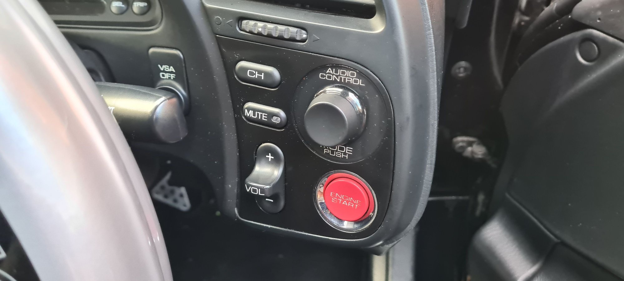

The volume up control suddenly stopped working the other day. All the other controls still work fine, including volume down. Stereo has been installed for about a year with no issues, problem popped up out of the blue.
The volume knob on the HU itself of course works fine. Its just the dash control that is not working.
I have a Pioneer HU, and using the ASWC-1 'steering wheel' controller. That device decodes the digital signals feed to it over a single wire from the stock dash controls, then controls the HU via signals sent to a 3.5 mm plug on the back of HU.
Since its all digital signals from the dash, through ASWC and to radio, it can't really be any of those components. Either they'd all work or none of them would. So I'm thinking it has to be the actual button switch on the dash itself.
The dash volume rocker switch is actually just two adjacent push button switches. Its only a rocker switch mechanically, as the plastic switch 'knob' just teeter tooters on a pivot, and therefore can only depress one of the volume buttons at a time.
But before I tear open dash to replace the switch (if I can find a new one to solder to the PC board, otherwise I'll have to find a used dash circuit board), I wanted to see if anyone else has ever seen a dash control button fail (and if they found a source for new button, would rather have button on hand so I only have to open dash once). Or if anyone has any different diagnosis to rule out.

I have the same problem just developed. I wonder if I gave ot a 'smack' with my knee getting in and out being a tall bloke.
You can clearly feel a 'click' on the volume down still but the 'click' has disappeared on the up stroke as it were! This clearly points toward a mechanical failure in the switch. I can buy a used panel on an 'on-line auction' for £15 so for the price I may as well have both options available, when I take it out.
Anyone have any tips images for removal please??
