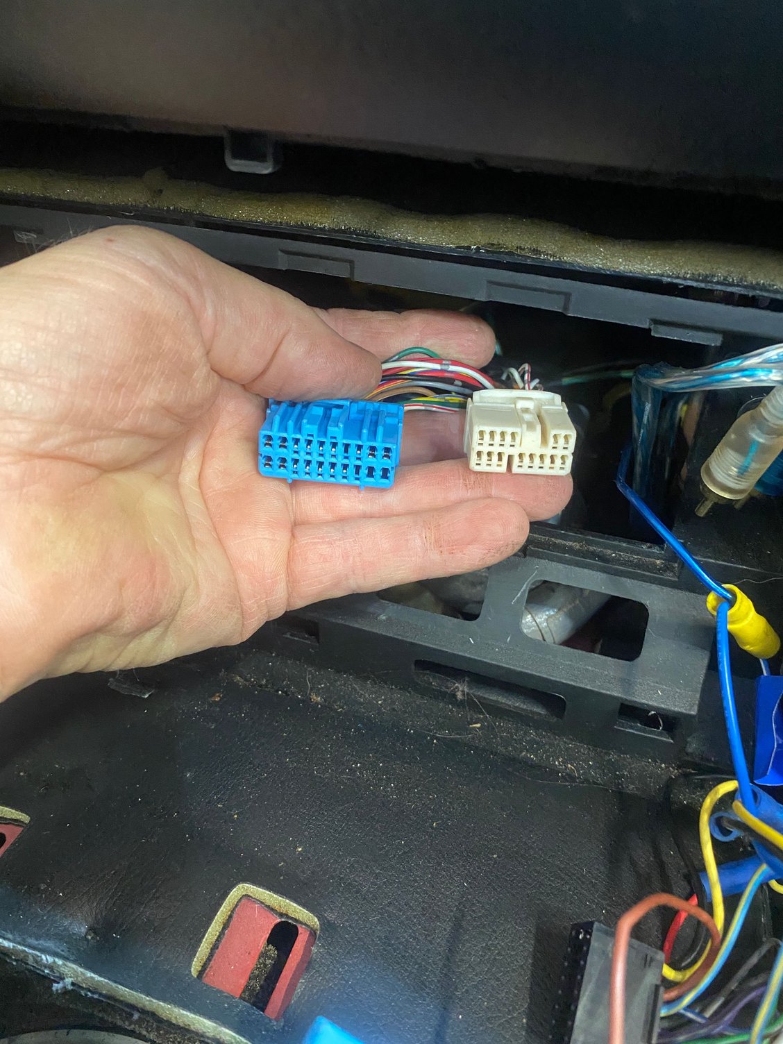

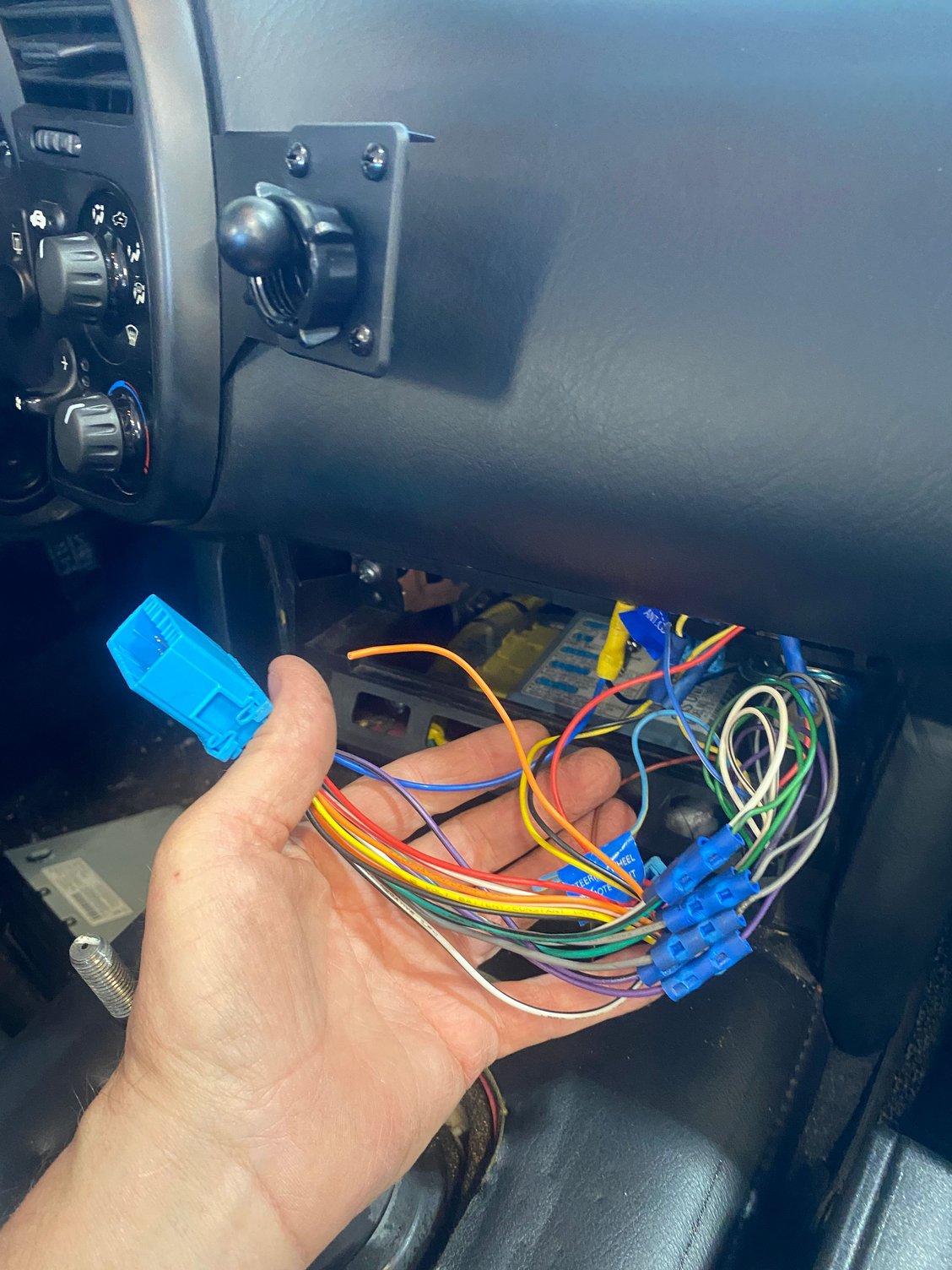

Ok, so I tore into this thing this morning to see what I had to work with, console and dash came out easy (I was concerned) Now some questions for ya.
Trying to understand the wiring on this thing, I'm thinking/hoping the last guy didn't mess with stuff too bad .
Are these the original plugs to the radio? So I can start from scratch? (Sorry the pics are so big)
And then this little rats nest unplugs and just goes with the radio I'm taking out?
I hope this is the case then I can replace this radio on my own! I need to relearn this stuff, been a long time!

looks right. the white plug might be for an optional accessory like the cd changer
