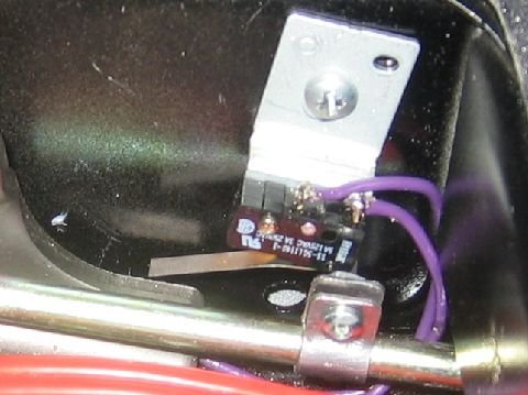

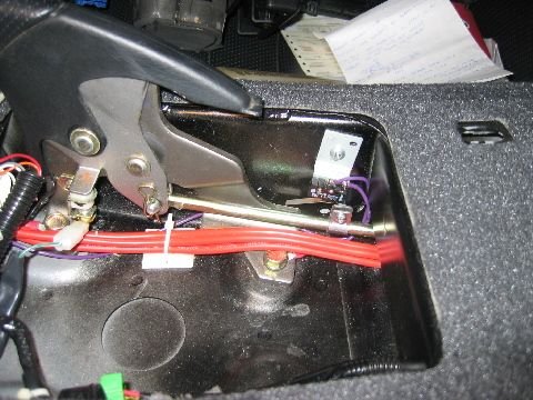

You can't use the factory parking brake switch as a safety because it is designed to ensure the brake is off, which means it senses brake position at or near the full OFF position. Applying the parking brake even one 'notch' will satisfy the factory switch but will not provide enough braking power to keep the car from moving. I needed a sensor to activate only if the brake was fully ON. To accomplish this I installed a micro-switch inside the tunnel which is activated by a bracket that clamps to the brake rod. The clamp is attached with a single machine screw which allows easy adjustment and the overly-long screw does double-duty by serving as the switch activating lever. See photo below.
When the brake is pulled up all the way the rod moves and activates the switch which is wired to bypass the clutch interlock, allowing the engine to crank. If the brake is not fully set the clutch interlock keeps the engine from cranking. In addition, I have a circuit to activate the brake pedal switch (simulates pressing the brake pedal) if the parking brake is released after the car starts. If this occurs the remote start system thinks the brake pedal has been pressed and immediately shuts down the engine (the brake pedal shutdown is a standard 'anti-theft' feature on remote start systems).
