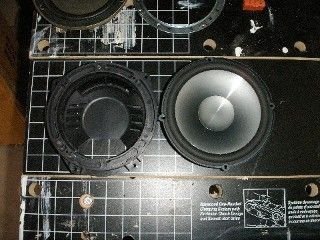

To give some background, I am 6'4", so I kinda wear the car and with my foot on the dead pedal, my leg covers the speaker grill. So components were the only real choice, and after listening to a dozen pair, I decided on a set of Infinitys. My problem was that the '01 doesn't have component speakers. This meant irreversibly modifying panels only 3 days into owning the car...

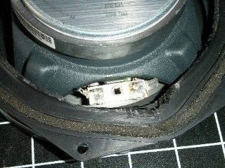

Step #1: The stock speaker basket was not deep enough to mount the speaker. I wanted to keep the basket, however, to maintain clearance on the window glass and to avoid any unneccesary drilling. The solution was to cut the back of the basket flush with a Dremel tool. I then used a wood chisel to smooth it all out and to trim out clearance for the binding posts. Note that there is a protruding tab used for alignment on the top that you want to keep..
Step #2: Attach the universal mount ring to the basket frame using the 3 screws removed when taking the factory units out of the basket. Put the foam gasket on speaker in the channel and then attach the speaker to the ring, compressing the gasket in the process.

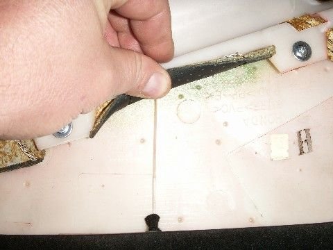

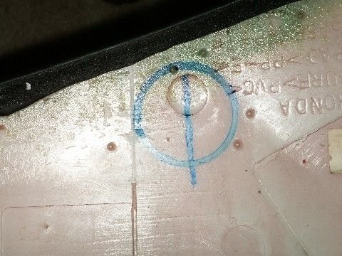

Step #3: Now on to the "fun" part. Note on the pictures that the doorskin plastic has a couple of quarter sized marks from the molding process. After a couple of measurements, it turns out the marks are in the same exact spot on both driver and passenger sides. I decided to use these as reference marks, centering the tweeter at the top dead center of this mark. This location required using the chisel again to trim back a support rib.
Step #4: The door panel is in 3 pieces

Just curious, though -- if moisture is a problem for the crossover, how do you protect the binding posts on the woofer and the solder points on the tweeter?? I assume that shorting would be a problem regardless of where in the circuit it occured...
Speaker Condoms I used little rubber grommets, then heat-shrunk them to fit.
