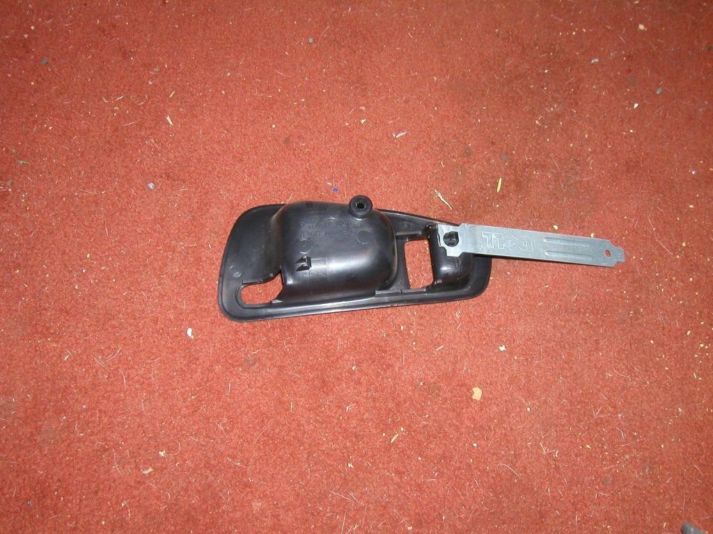

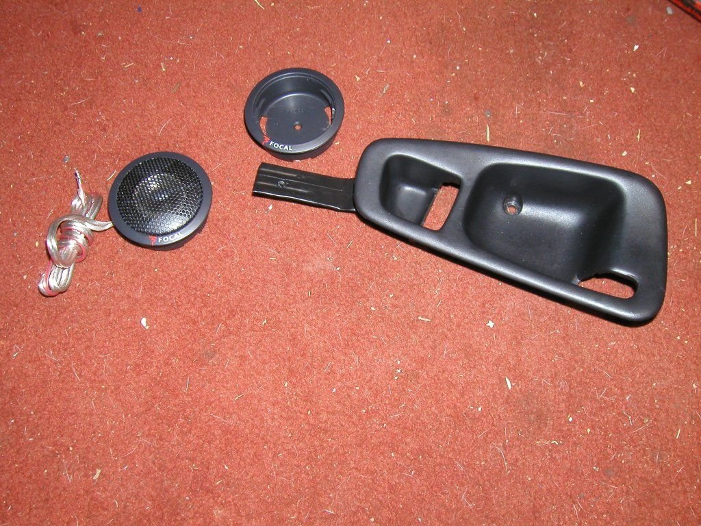

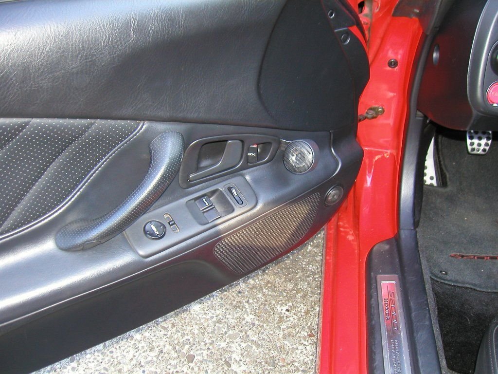

I mounted my focal tn51's in the doorlock hangers using inexpensive computer slot covers as the hangers. The slot covers are firm enough not to bounce around but malleable enuf to angle them where you want. I also have a set built into the doors in the angled position by the 6.5's.
Sounds excellent with great clarity and great separation and they are semi-hidden.
