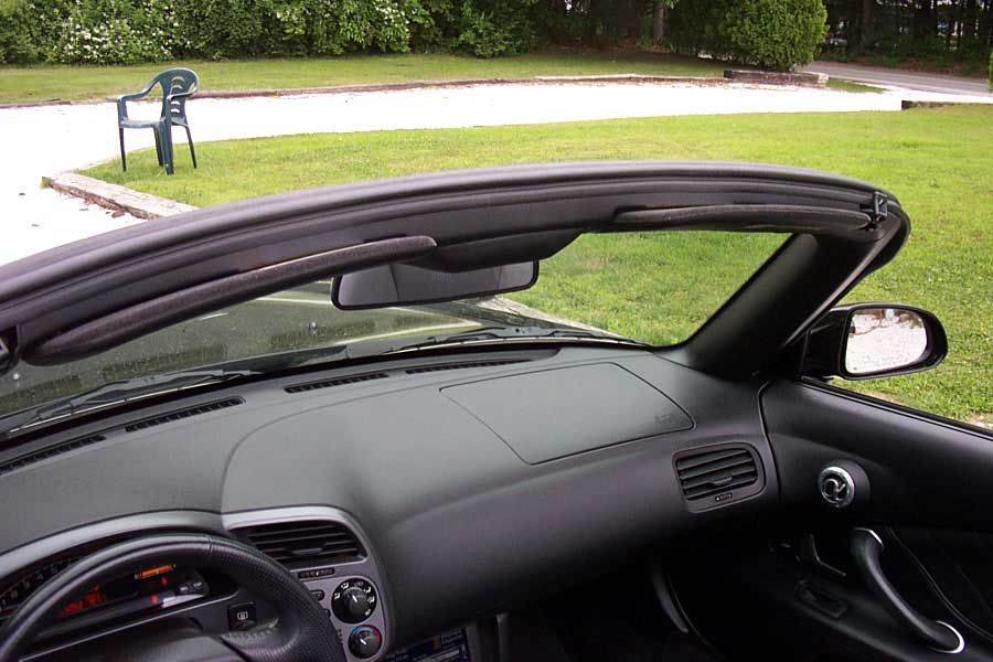

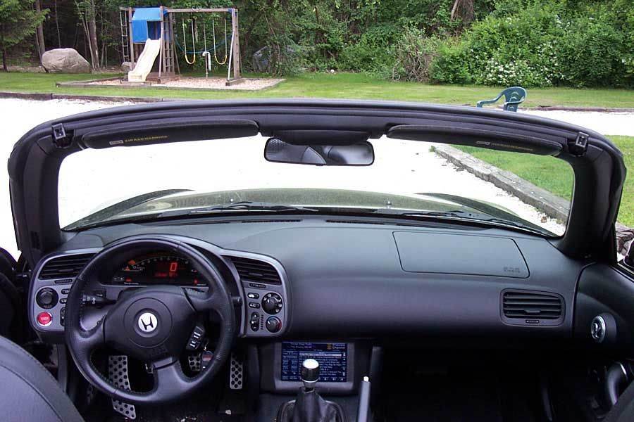

I have seen the other V1 mount that was made for the S, placing it above the secret compartment. I liked the stealthiness of this, but I researched alot and found that the higher and more forward you place the detector, the better your chance of catching the stray signals of an instant on radar gun as the officer shoots cars ahead. Same thing for stray laser waves bounced off of cars ahead. So, I decided to mount mine above the rear view mirror. I did not put a rear window for rear laser detection as I have no use for it. If you get hit from the rear with laser, you are toast. Radar covereage in the rear will not be effected. Also, many new cars are coming with laser guided cruise control which is a PITA if you get falses from them alot. I may change my mind and put a window later, but I doubt it.

Location where V1 is mounted:
Stealth cover installed. Look no boogers either! :

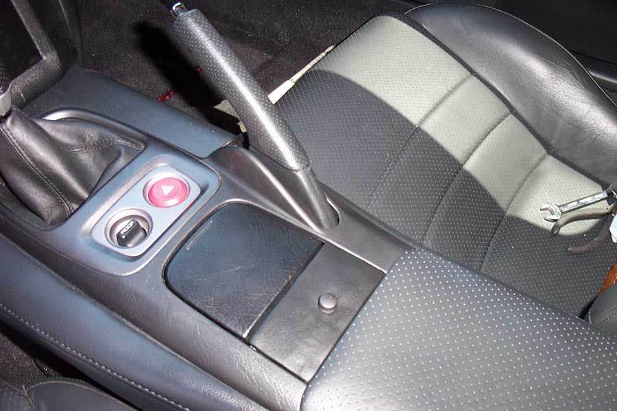

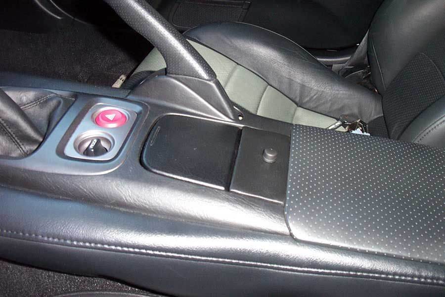

V1 remote switch:

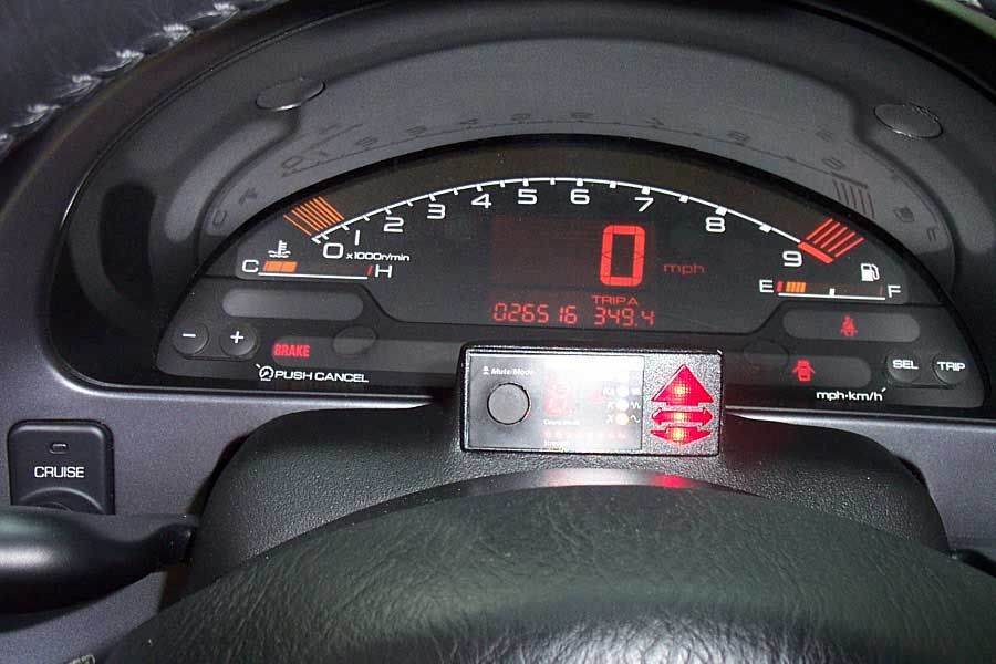

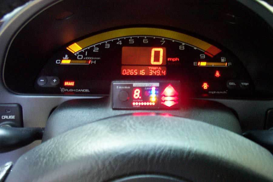

V1 remote display:
It is hard to tell in the pics, but I have the LEDs for the different radar bands in different colors now. Red is laser, blue is Ka, green is K and yellow is X. Makes a big difference.

So you have a cutout for the front of the radar dectector sensor? any pics of that section?
I would totally beg to differ that the REAR detection is not needed - it has saved me many times in telling me when I passsed a bogey, it changed direction and now is coming up on me from behind.
In your setup you would not know once he passed you since you blocked the REAR sensor! hahaha
Nice look but I think you need to modify that enclosure....

No, I am not saying I don't want rear RADAR detection, I do not want rear LASER detection. Fiberglass does not obstruct radar in any way.

I am still waiting for my remote display to come in to complete my stealth mount. I did manage to get the remote power/volume switch done:
The remote display should be in early next week and I will have it all glassed up and completed soon afterward.

No, I was concerned about that, but my arm sits to the left of it in a natural position. It actualy makes it easy to mute since I can just nudge the knob with my elbow if needed.
I had wanted to mount it right near the roof/hazard switches, but it would have been a serious soldering and re-mounting job. It can be done though.
