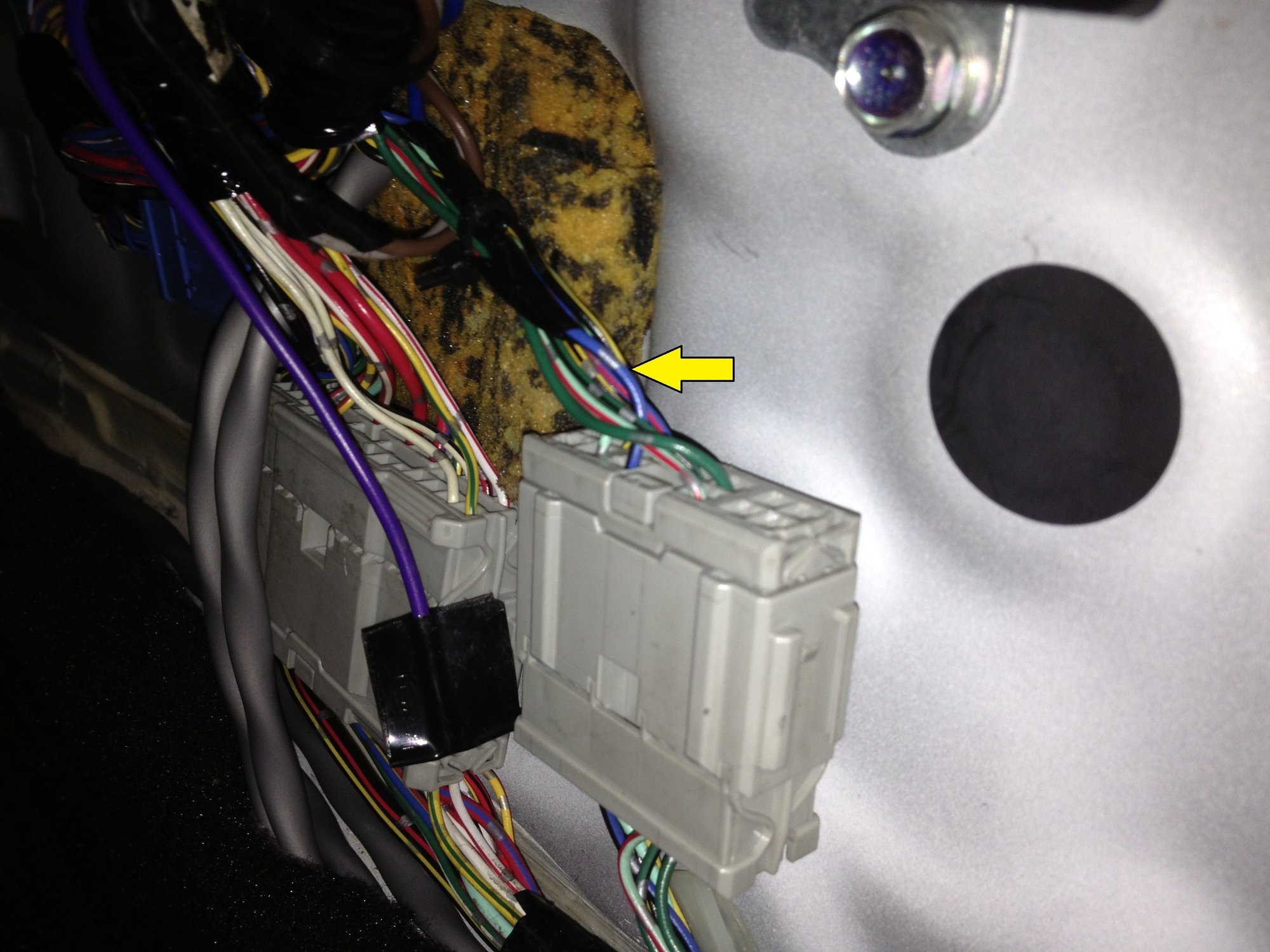

Just did the install over the weekend. The note is on the first page but see diagram and photo below.
1. Tap into H1/1 Red from the 6 pin harness after the fuse for fused 12V+ that connects 86/30 on relay.
2. Connect H2/5 Red/White to 85 on relay.
3. Connect 87 on relay to Blue/Black trunk release wire in car harness as seen in the pic on page 1.
