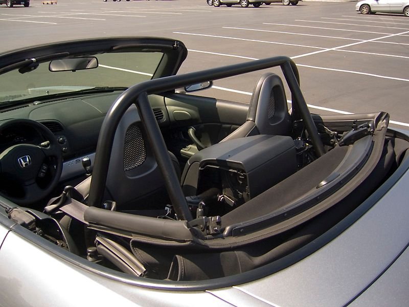

I recently undertook a journey of some fairly major changes to my S2k to make it a much safer car out on the track and had some interesting opportunities to enhance the sound system in the process. We stripped the interior out to add in a welded in roll bar
which replaced the OEM roll bar and the cross brace behind the seats that most of the OEM interior trim mounts to. The car is far stiffer than it was with the OEM bracing so we didn't lose any structural integrity in the process which is great for the track. The driver's side seat is about to be replaced with a Sparco Modena seat which will be fitted with a Schroth Hybrid III 6 point racing harness.
