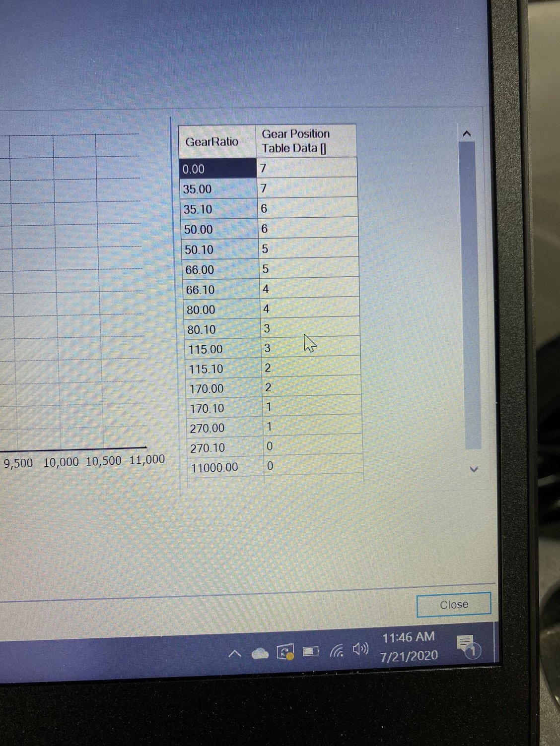

I ended up having to modify my gear ratio setup a little, and I'm guessing it is because of the 350z trans and DD speedo interface. I used the gear ratio table setup video from this link: https://www.dropbox.com/sh/35x6udc2p...WLdAcTDCQDhl3a I'm not sure who's videos those are, but I would love to thank them! Now my gears read correctly, time for some gear based boost!!
