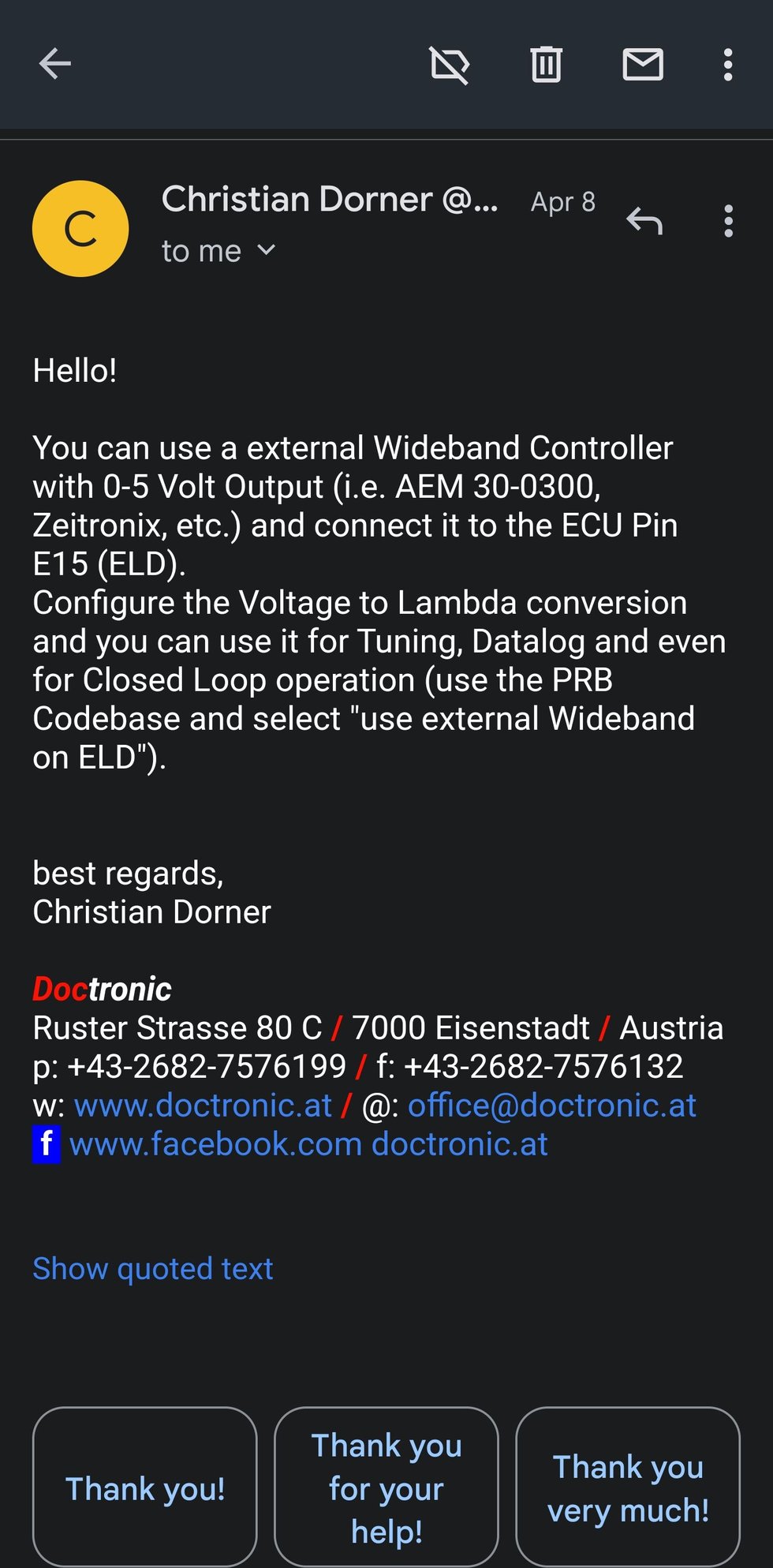

Anyone in here uses an AEM X-Series UEGO Wideband with the ProECU?
I just ordered one and wondered if my cable wiring will be correct:
  • AEM: White Cable 0-5V Signal to Doctronic ELD Input (Pin E15)
  • AEM: Black Cable 0-5V Signal Ground to Doctronic Ground (Pin E4)
  • AEM: Black Cable Ground to Doctronic Ground (Pin E4)
  • AEM: Red Cable to some +12V source (preferable with 5A fuse) - maybe an emty spot in the fuse box?

This is an email from him when I asked about this setup. You maybe right.

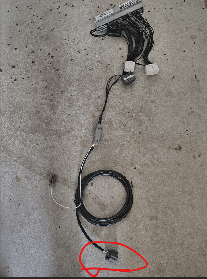

Can anyone with the 'AF subharness' option that is using an RSX type sensor (part no. 36531 PRB A01) tell me if I have mine set up correctly? I am not getting any AFR/Lambda readings but I am getting fuel trims and O2 voltage readings on primary and secondary.
I have a brand new OEM upstream sensor in the header, and it's plugged into the primary 02 connector above the transmission.
The original secondary 02 sensor I removed and the connection is left unplugged.
The 4 wire rsx sensor is in my test pipe and gets connected to this thing:

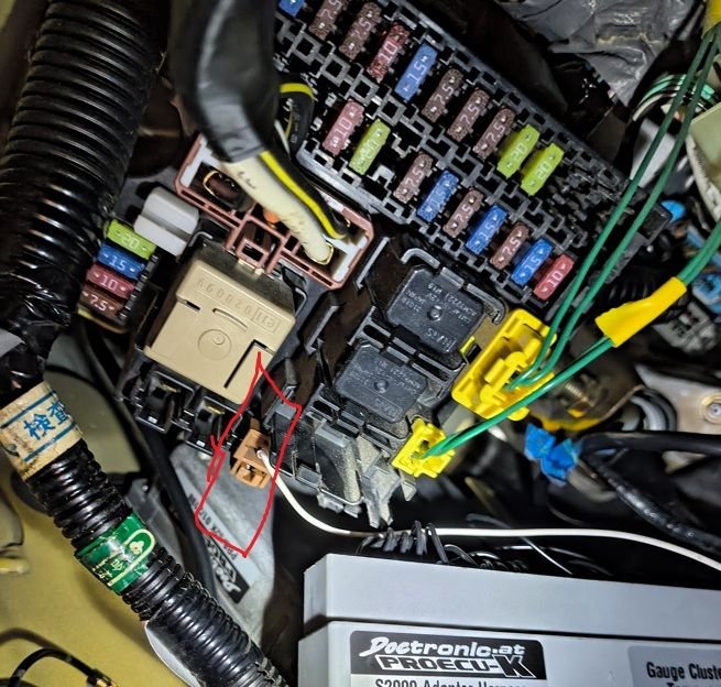

Those wires go into pins A1, A6, A16, and A22 according to a PRB pinout diagram. Then I am using this 12v ignition for power:
If 'use secondary 02 input as primary' is selected then:
-No AFR/Lambda readings
-CEL for secondary 02 heater circuit
-No fuel trims
-No primary 02 voltage, but there is S02 voltage
If 'use secondary 02 input as primary is NOT selected then:
-No CEL
-Fuel trims are present
-There are P02 and S02 voltage readings, but they are both the same as if they are both narrowband
