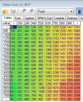

Actually, I even don't understand in what "unit" are these values, for example in this S2K basemap:
This doesn't seem to be "ms of injector opening", so what is it ?
I also looked at the flexfuel possibility: there are only correction tables (fuel and ignition) that apply to the gasoline tables, in correspondance with the % of ethanol in the tank. Isn't that a little bit too simple ?

Also it is in milliseconds. When I upgraded injectors it needed the dead times plugged in and then the entire fuel map was edited. If it were in ve it would have wanted injector size and stuff and should have done the work for me. Ve is nicer, but MS works just as well, just requires a bit more smarts.
