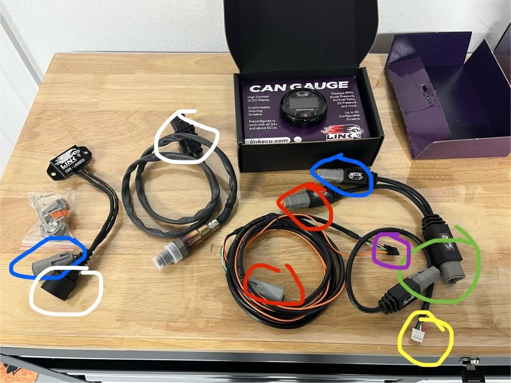

I have the link wideband and gauge but have no clue how to install it and the wires don’t appear long enough to reach inside of the car like the aem.
for anyone who has installed the link wideband and afr gauge would you be able to explain how you did it?

I have a LINK wideband and gauge that I’ve been waiting to install. The one thing that was preventing me from installing this for so long is that the wiring wasn’t long enough to reach from the o2 location in the header to inside of the car where the ecu is. As you can see in this picture, the two connections circled in white need to be extended.
reds connect, blues connect, greens connect, yellow goes to ecu, purple goes to gauge. I didn’t know where to buy a harness extension as LINK doesn’t sell one. I was just recently sent a link for the extension I need so I will be buying that and installing this.
just out of curiosity though, for those running the LINK wideband and gauge, how did you solve this issue of the wiring not being long enough?

Have you called LINK to ask about expansion harness? ive called them once to ask ecu specific questions and the customer service was top notch. (also, i would just de-pin the plug and extend the wires)
