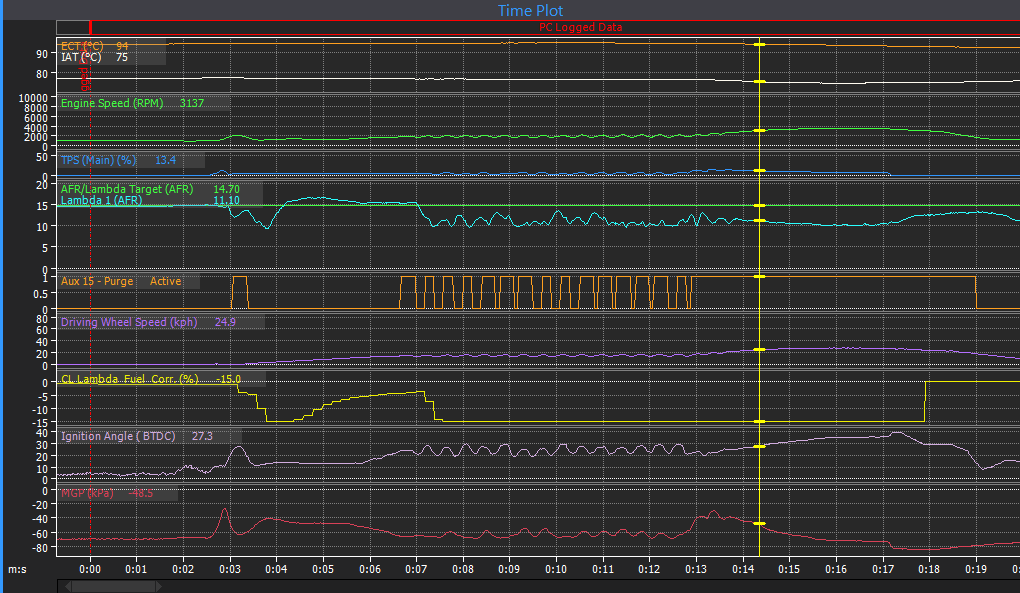

Adam from Link had found that in a few of the LinkECU logs provided (from users here), that there is a correlation to erratic AFR traces likely contributing to the "bucking" or hesitation issues whenever the Purge solenoid is activated at a certain IAT threshold.
Along with this, while the Purge solenoid is active, the logged AFR value barely ever tracks the intended AFR Target, so Closed Loop Lambda was sporadically trying to correct the logged AFR as a result.
We weren't sure if the issues were related to Wideband o2 configurations or wiring issues, faulty sensors, or another auxiliary output issues, masking the root cause of the problem.

You can see here in - I believe Sonic9's log file from March 25th - the bucking issue is apparent when the solenoid valve activates in orange.
For the first 3 seconds, AFR tracks normally against AFR target - then by the 4th second the Purge solenoid activates (170° F IAT), AFR goes mega rich to 9.44, and Closed Loop Lambda immediately tries to pull 15% of its maximum allowable fuel to get AFR back onto the 14.7 AFR Target.
You can see the "bucking" occurring for almost 7 seconds as the Purge solenoid rapidly cycles on and off and Closed Loop Lambda is pegged trying to pull 15% of fuel out..
S9 bucking
S9 bucking

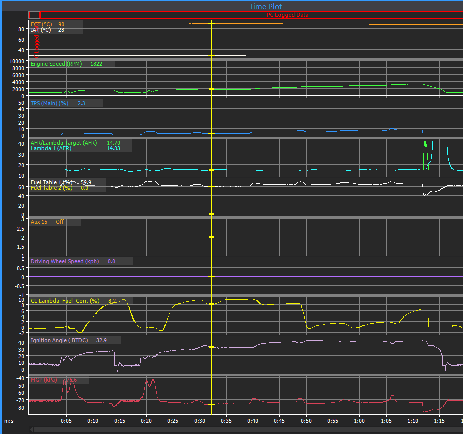

Conversely in TexasRoller's examples overnight - with Purge disabled and Closed Loop Lambda enabled - AFR is almost always on Target, with CLL still doing a fair amount of work in yellow, adding roughly 3-9% of fuel
TexasRoller CLL on
TexasRoller CLL on
With TexasRoller's Purge disabled and Closed Loop Lambda also disabled - AFR is still consistent, but its a fair way off target in some portions - at sections 15% leaner than Target AFR.
