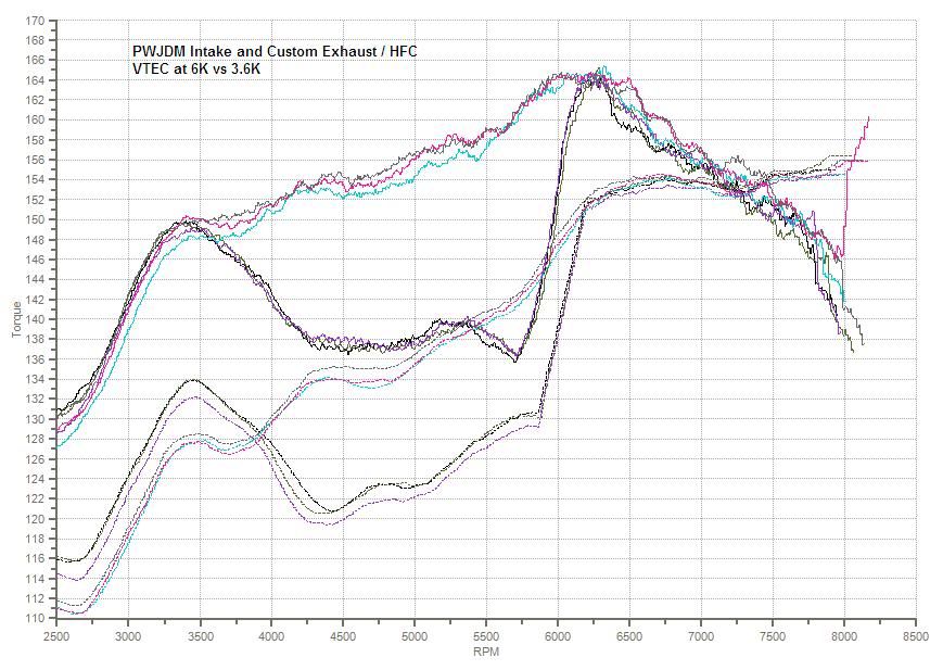

well, sorry to tell you this but 4.56 is no more. i would love a set but oh well. with my tuned car and supporting mods, my vtec is at 3600 and boy is that fun. but i see what you mean and i totally agree with you. in the car isn't in vtec, i am glad i have gears to just punch it around town in the lower rpms without going into vtec. in that case the gears are fine. there is a combo that could get you 4.61ish gearing but there is nothing that can get you 4.56. if you feel that the stock power is enough for you and you just want to have some fun around town driving and hate the lack of low end torque, then gears would be for you. with all my mods and flashpro, the bottom rpms still felt sluggish. and didnt really do the trick. gears solved that for me. i think 4.44 is the best choice for me but a compromise. good enough for around town action and stop and go but still livable at freeway speeds. it doesnt give you the kick of 4.77 but it doesn't make your car scream going down the freeway.

Just remember that gearing changes don't "add" performance. They just move it. When you go from a 4.10 ratio to 4.44, then you are simply giving up a LOT of performance between 34.5 - 37.8 MPH in order to have better performance from 0 to 34.5. You are also giving up a LOT of performance from 53.5 -57.9 in order to have slightly better performance betwwen 37.8 - 53.5. You are also giving up a LOT of performance 73.8 - 79.9 in order to have slightly better performance from 53.5 - 73.8. So if you do the math, the only way you can be sure that a 4.44 equiped car will "beat" a 4.10 equipped car is if you are drag racing from a stop. If you drag race from a 25 MPH roll, the stock geared car has a good chance of winning. So gear swaps should not be considered "performance adders" at all. They are just performance changers.
However, a few choice bolt-ons and a custom FlashPro tune definitely is a performance adder! There are no performance trade-offs, just better performance, especially where it's needed the most ... the midrange.

I should mention that with the flashpro I raised the redline to 8500. That brings the speed in each close to stock.
