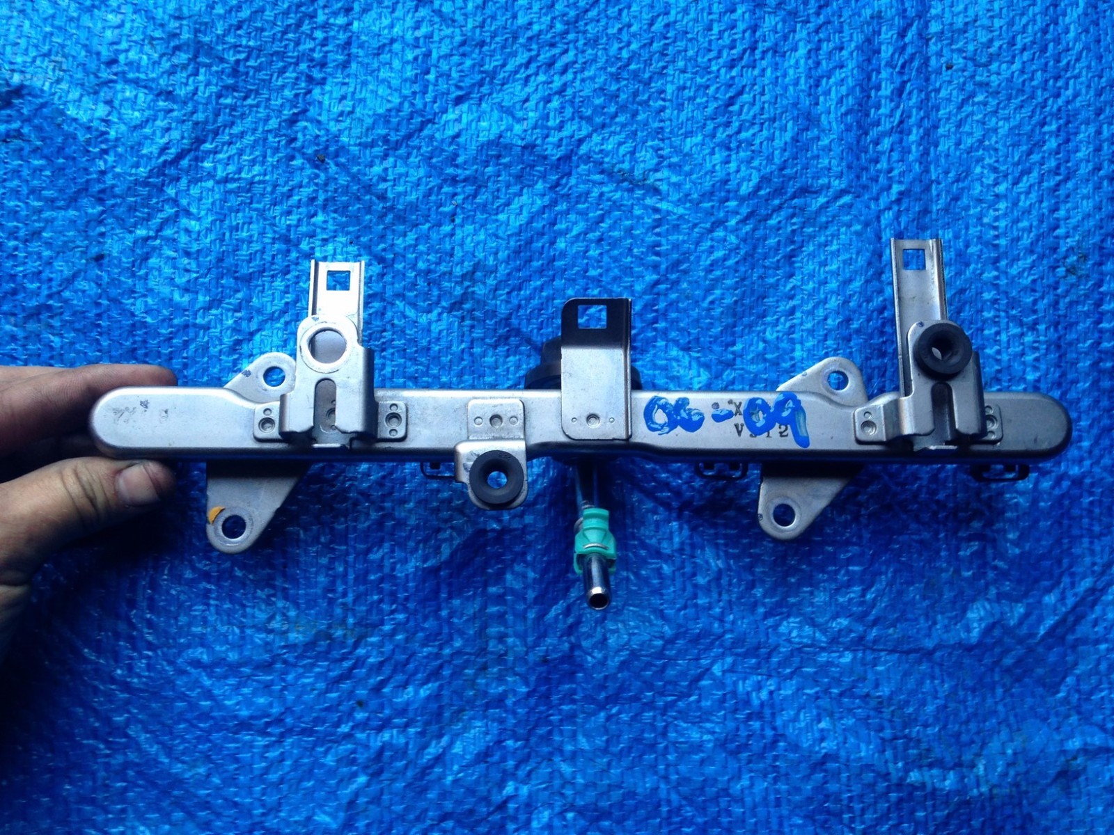

I'm looking to possibly convert my returnless fuel system to a return style. I haven't stared at my fuel rail recently, but I'm thinking it's as simple as drilling a hole to the stock rail and welding a bung to route to an external FPR. Am I missing something?
One of these
and this

Yep that will work.

Yep, that's all we've done, although it's rather difficult to see on this photo, there's a fitting in the end and a pipe goes around to the other rail (the pipe is loose so look a bit further up)

Is the rail AL or steel?

It's steel, there's a zinc coating on it though you'll need to sort out before welding/brazing.
