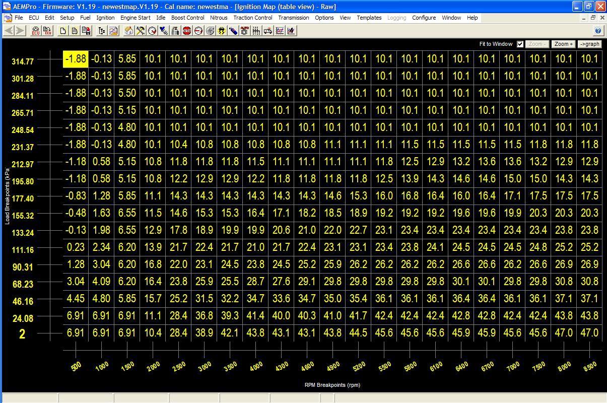

I have no problem sharing my maps. Here are some screen captures. In the end, everyone just needs to be aware that every car is different and using someone elses map may not work too well and could cause severe damage. Always work your way up to WOT and full boost while monitoring/logging every step when trying something new.
Final comments: Mine is self tuned on a few dynos. I've been through EFI 101, EFI Advanced, and was in charge of tuning our SAE CSC snowmobile in college.
My tune is conservative. I use boost comp, but without a throttle modifier (I hate the throttle mod). Instead, I edit the vacuum ranges of the fuel map to perform the same function. I have excel spreadsheets to do the same to any tune. The benefit of doing things this way is much greater granularity/control.
