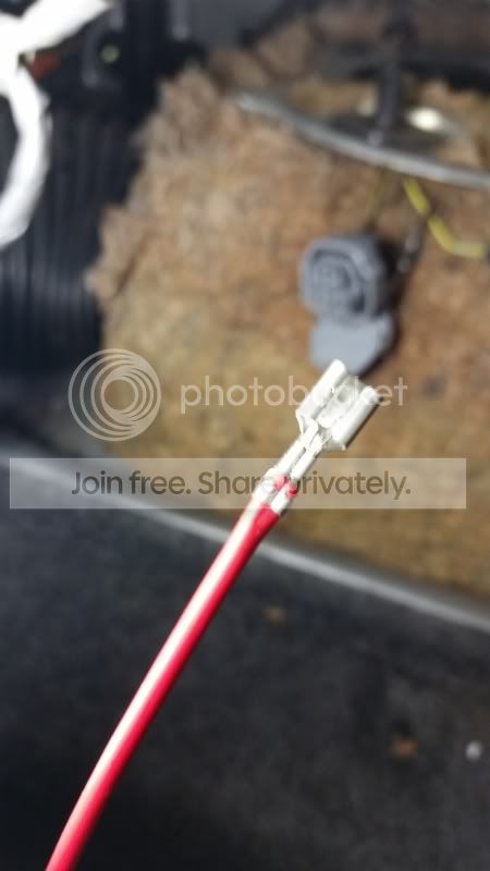

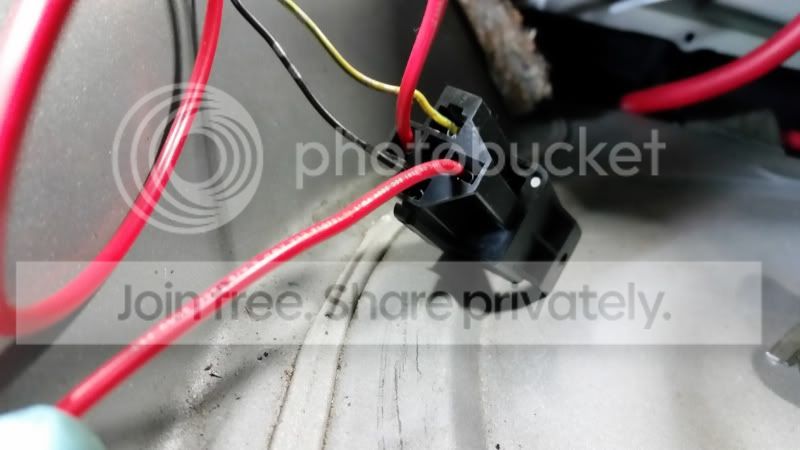

However, we did notice some weaknesses when wiring the plug thats included with the SOS relay. We found those thin plugs/clip things shown here:
that are inserted into the relay plug here:
are pushed through the plug holders when the relay pins are pressed into that plug. Sorry if I'm making no sense. We had to be sure those plugs that insert into the relay plug are solidly connected when the relay is inserted into plug. The main power wire of mine was getting pushed out and not connecting at all. Eventually, we made sure all relay posts inserted correctly and all seems well.
