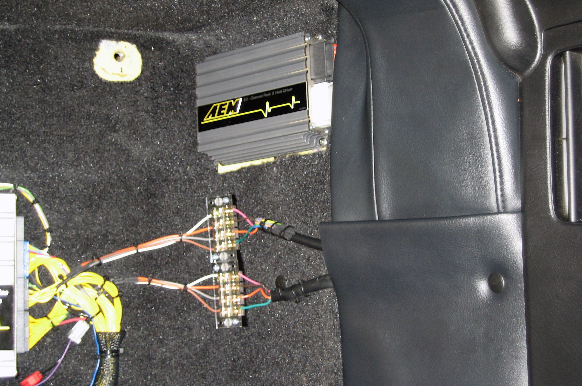

Just finished installing an AEM 10 channel peak and hold injector driver. Here is a picture of the location:
I'm still running with the 750 cc saturated injectors, but will be switching to 1000 cc RC P&H injectors when I get back from a 10 day Europe trip. The driver circuit works fine with the saturated injectors, except that it is running a lot richer. I suspect this is due to the injector offset parameters are way off now. I'll keep you posted on the tuning.

Sorry for the dumb question but for what is that? which benefits have?

It's an electronic driver circuit for peak & hold injectors. You use it to drive the injectors instead of a resistor box. A resistor box changes the characteristics of a peak & hold injector (low impedance) to those of a saturated injector (high impedance). The response time goes way down.

what advantage does it have over a resistor box fperra?

Running a resistor box with peak and hold injectors turns them into saturated injectors. Their response time is not near as good. Large injectors will idle much better with a peak and hold driver. No HP advantage that I am aware of though.
