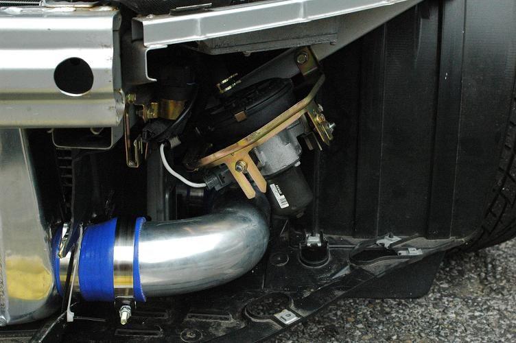

why do you guys remove it?i figure its gotta be weight savings/its a waste of space/no room after installing intercooler piping.i was going to remove the pump but didnt want the check engine light so i just remounted it in a new location.

Mine fits fine with my ultimate racing FMIC. I don't know where I'm going to attach the hose yet, though. I need to get 2 bungs added to my inlet pipe.

The air pump injects air into the exhaust on initial startup for emision purposes until the cat and the O2 sensors warm up enough to do their job. When you go turbo, emisions go out of the window for the most part... you are already killing trees as you drive by . Also, a stand-alone like AEM EMS doesn't have OBD-II instructions in it, so the pump serves no purpose.
