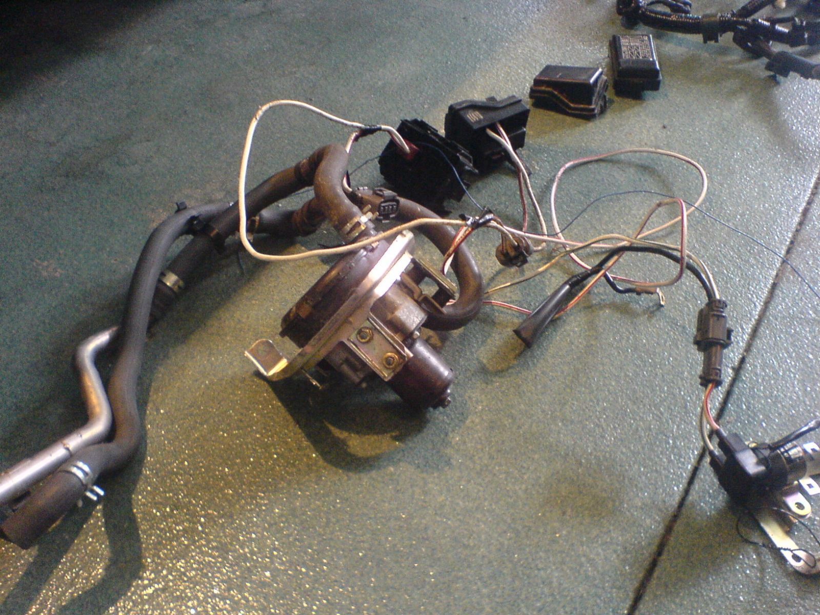

im in the process of removing mine now, i will see if i can get it out with no check engine light

the only parts you need to keep are the power steering fuse and the air pump fuse, we are gonna eliminate all the rest
