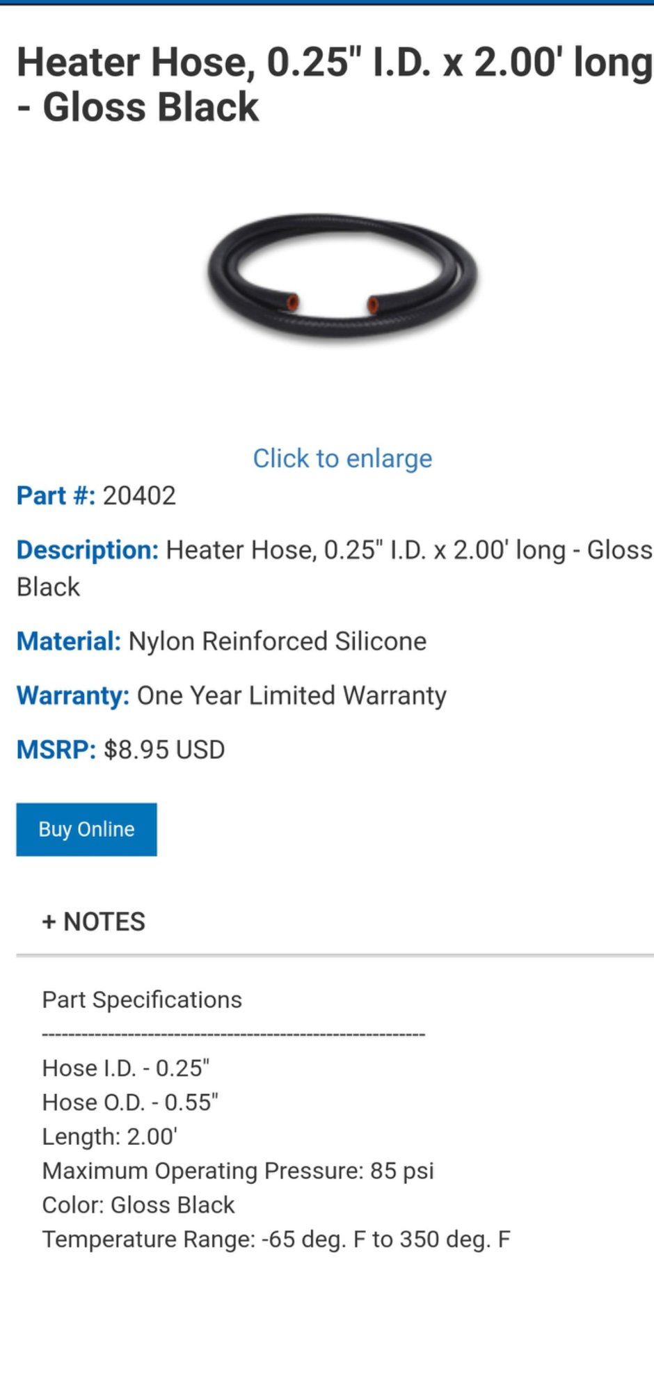

I saw your running what looks like silicone vacuum hoses to the wastegates. Probably from Vibrant performance i used those aswell but mine developed a tear pretty quickly. What you want is their reinforced silicone vacuum hose. Those withstand much better pressure and heat:
These are even cheaper on summitracing or jegs highly recommend.
