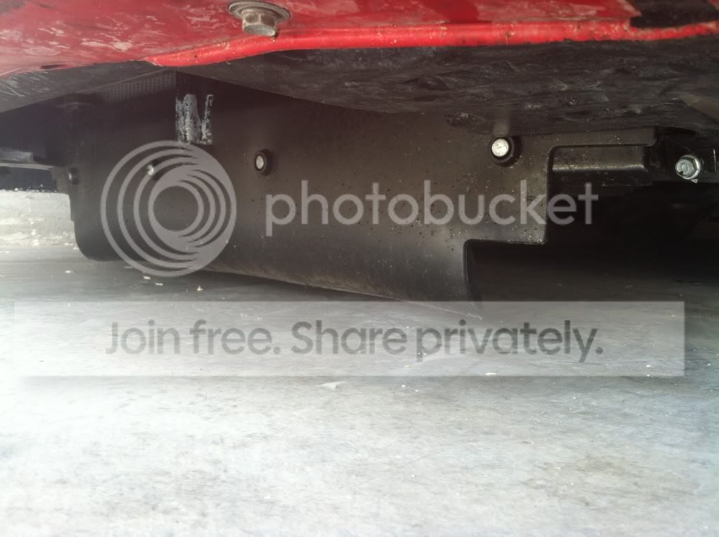

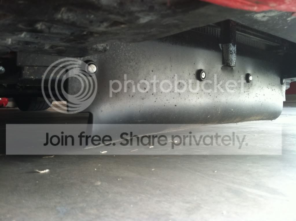

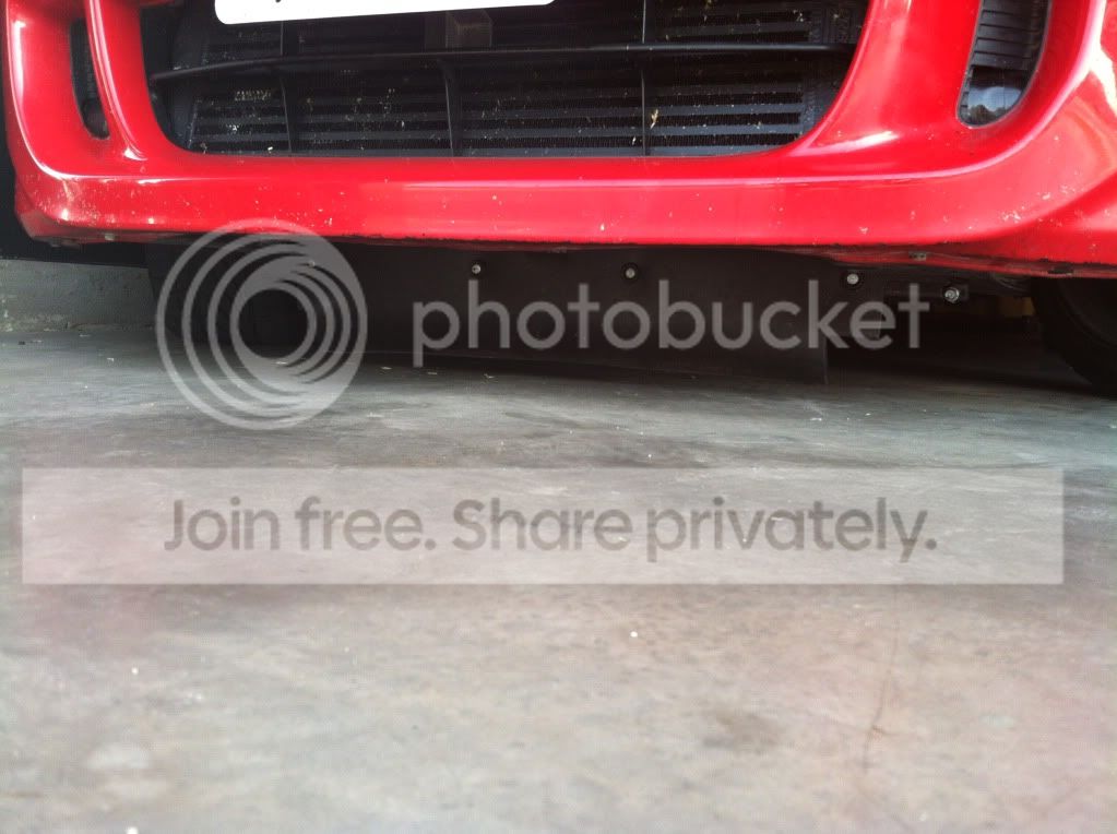

The car is already overheating with those temps, i would recommend adding an Air Dam to help with the air flow going in the radiator, i was having similar heating issues, due to the blockage of the radiator with the inter cooler, once i did this mod the heating issues went completely away, the air dam is from a C5 Corvette

Old Aug 9, 2012 | 12:54 PM
jordannn93's Avatar
Joined: Apr 2011
Posts: 1,419
From: Olyphant, Pa
Now i cruise at 199 with ac on, in 113 degree weather
Also it will help to add two Spal fans
Any pictures of this installed? How much is it to buy? I also might try to tilt the heat exchanger.

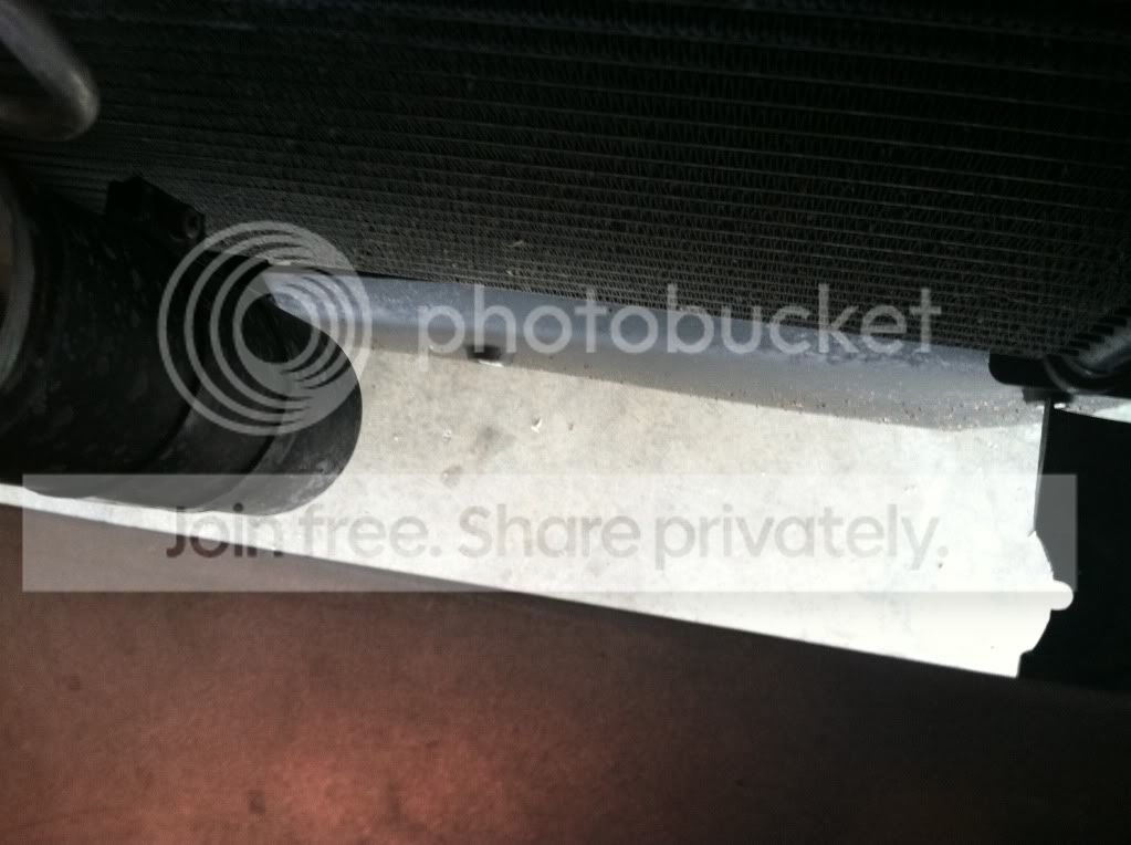

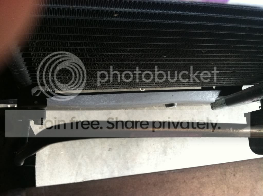

Here you go....
The air dam is about 60 plus shipping and i got it from this website
My link
