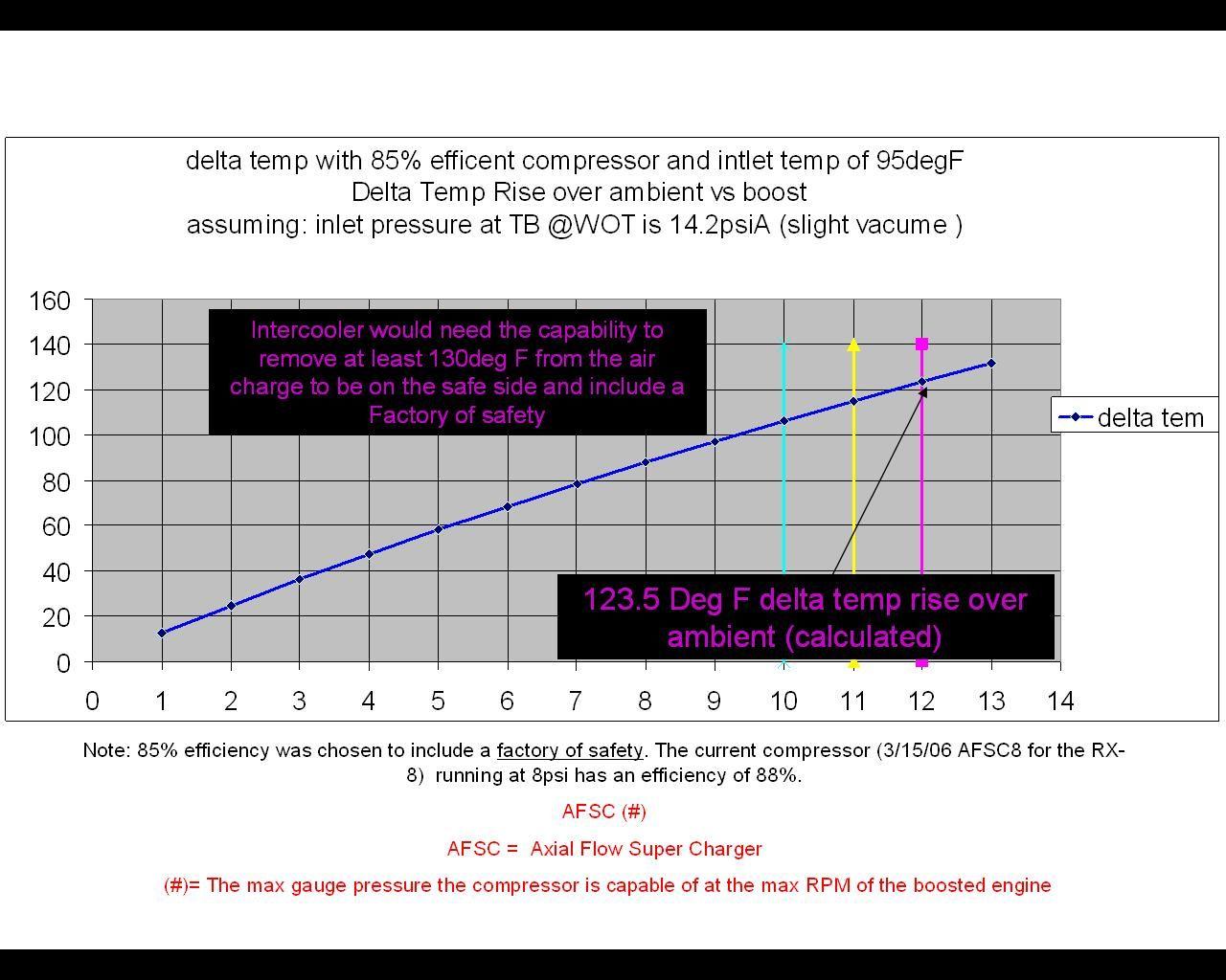

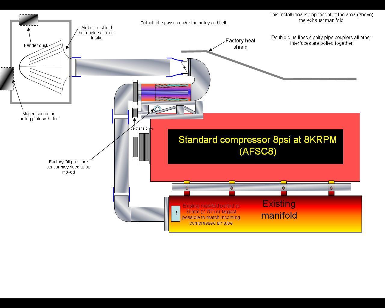

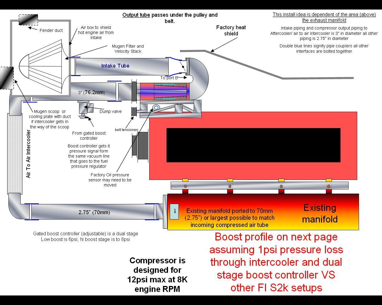

For everybody that is still waiting for RP to start integrating the AFSC for the S2k here are some ideas and thought I have sent on to RP.
Since the start of the AFSC I have wanted a compressor capable of putting out 12psig at 8krpm ; the boost profile image/graph shows why.
Now remember its about flow rate not boost pressure. But for these comparisons I chose boost profile to compare the different compressors because it an easer concept for most people to envision.
Big Note: In no way do these ideas represent what RP is going to do with the S2k AFSC when it is installed. They are my own personal ideas on ways to integrate the blower on to the s2k. Not to say RP wont take these ideas and use them to get started.
Standard setup 8psi max AFSC8
AFSC12 with PWR aftercooler
AFSC12 with Air to Air
Boost profile comparisons
Temperature profile AFSC12
