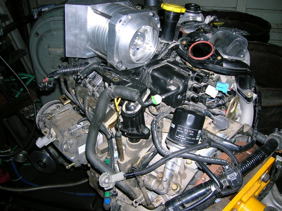

Here is the latest tidbits I have gotten from RP/RX-8 fourm
Disclaimer:
Note the info provided here may change and all info at this time relates to the RX-8 development unless stated otherwise.

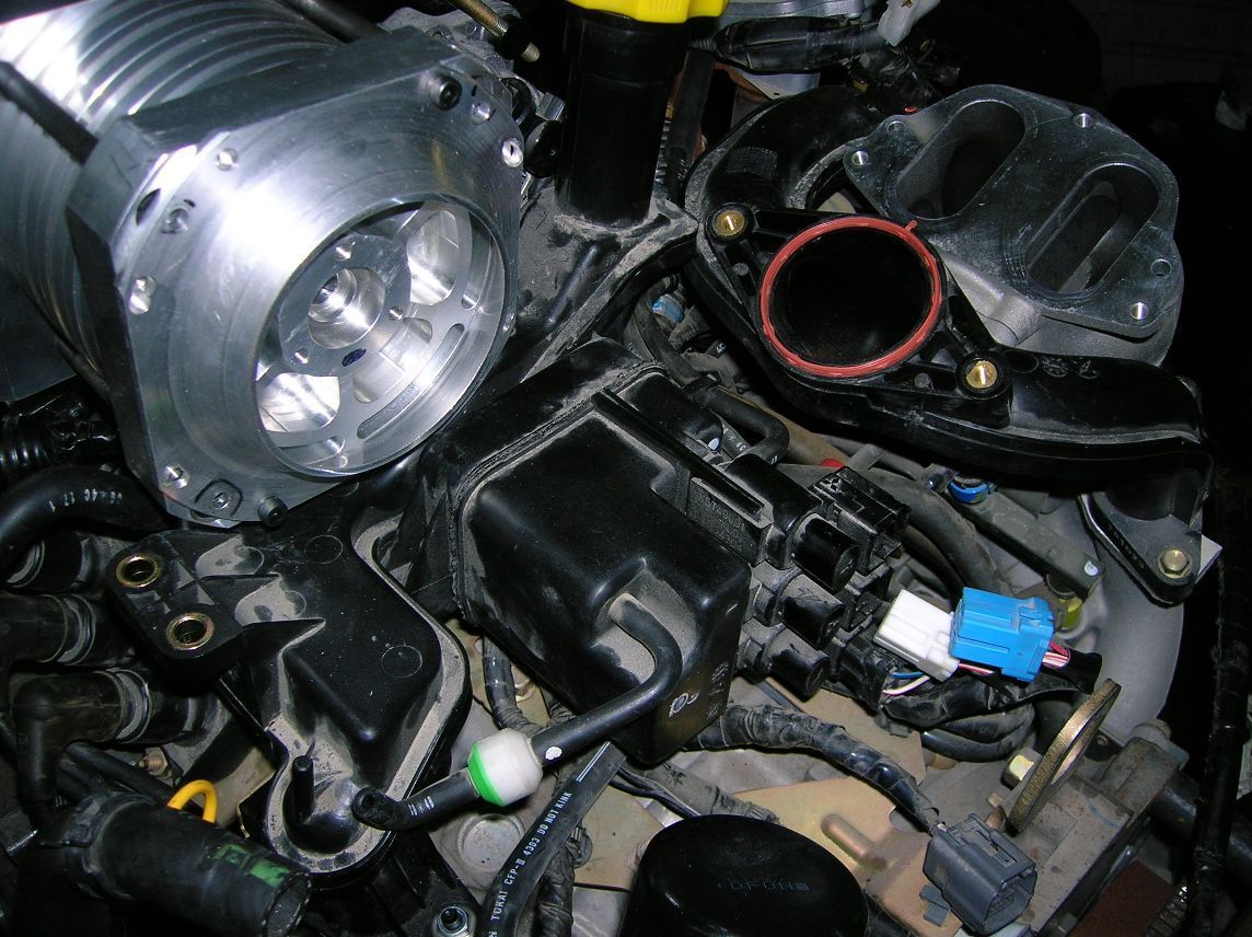

RP has attained +85% efficiency at 10psi (this is with no after cooling compressor only)
Total system Efficiency will go up once the latent heat of evaporation of the fuel once added (before compressor) cools the post compression air mass. At my last info from RP the blower for the S2000 would run pressures in the 8pis range.

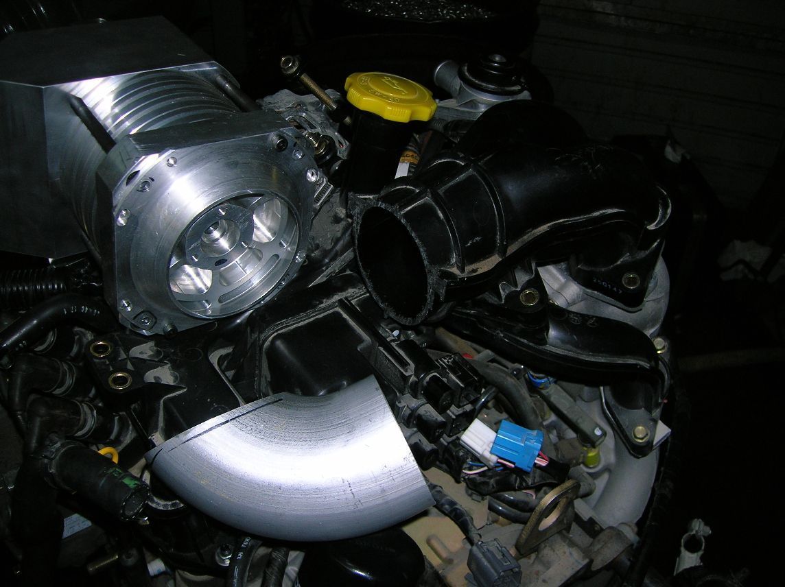

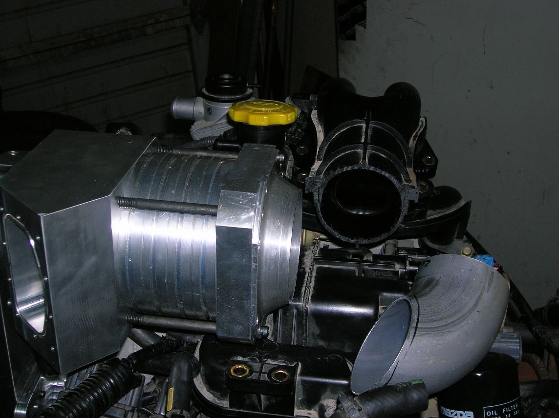

Manifold flanges (RX-8)are being cut with manifold tubing to follow.
Compressor blade design has ben finalized (RX-8)
The compressor is undergoing endurance testing to conform there is no bearing wear and shaft alignment are perfect. Remember this entire compressor is manufactured out of a solid piece of billet aluminum cut on a C&C machine so the design is repeatable down to the level of accuracy of the C&C machine.

Update: RX-8 Version of the AFSC is progressing.
Key note: RP has now got the current design (RX-8) compressor running at 36,000 RPMs to produce 7.3 PSI at an efficiency of 88%.
(The compressor can be spun up to +42K rpm for more boost.)
He is getting closer to finishing the RX-8 AFSC..
The S2k version is just around the corner
