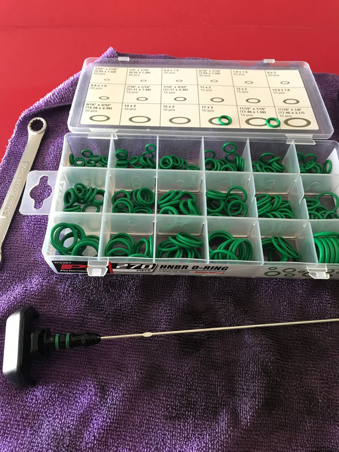

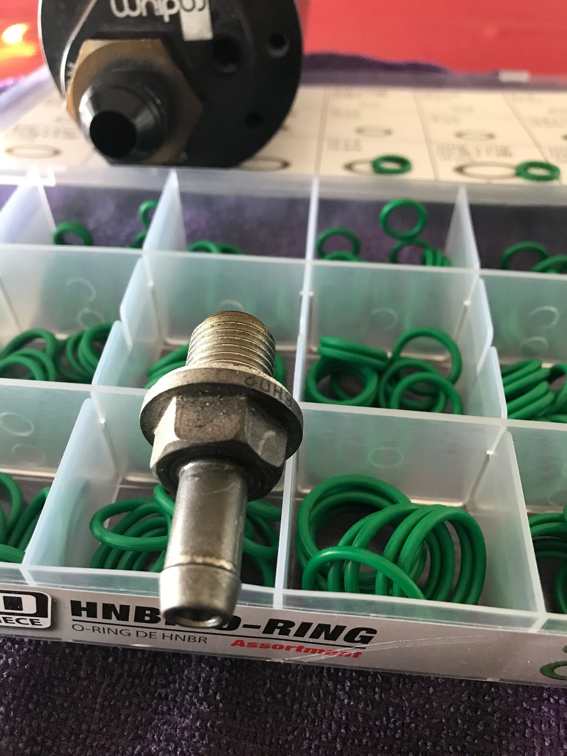

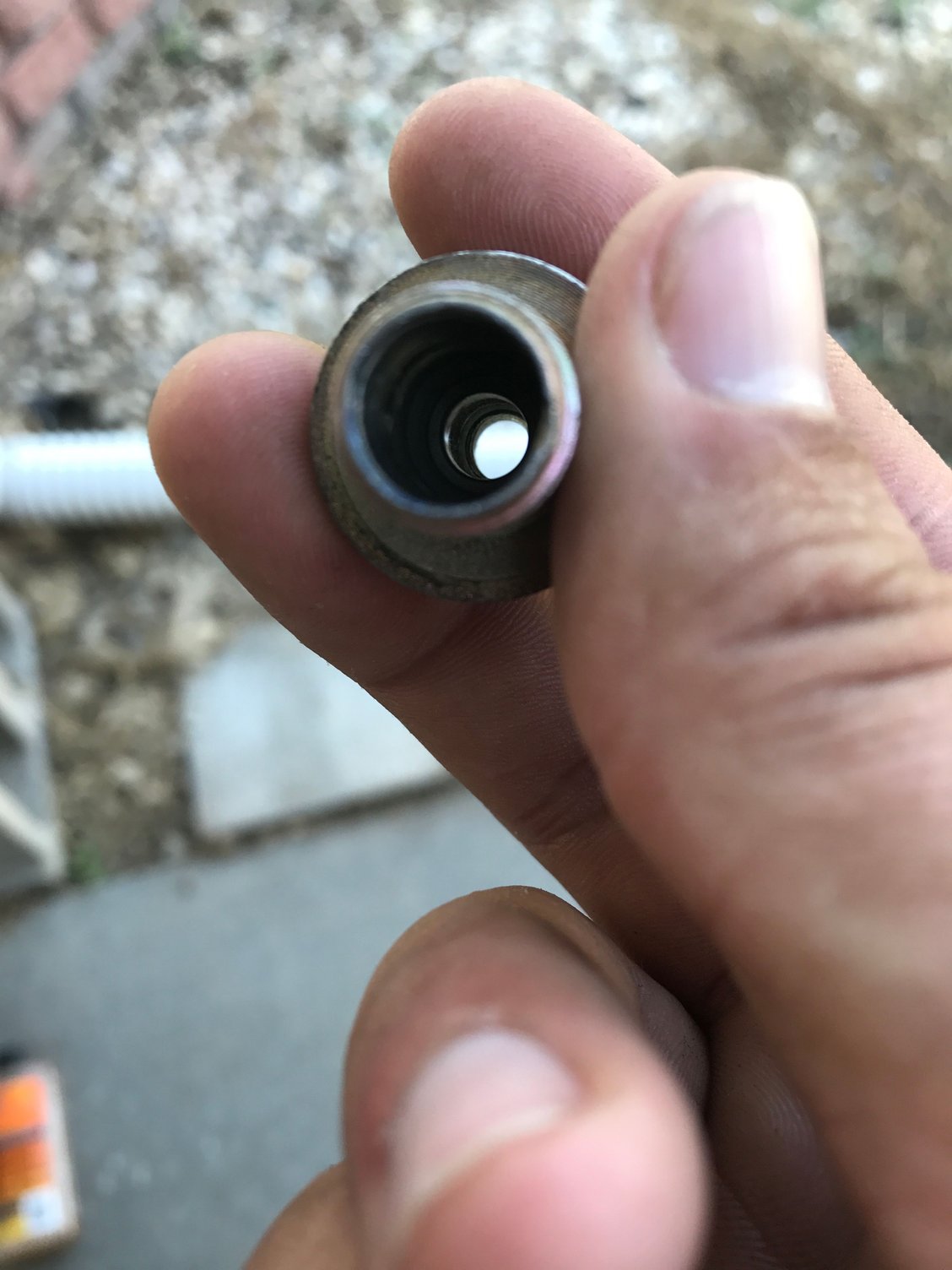

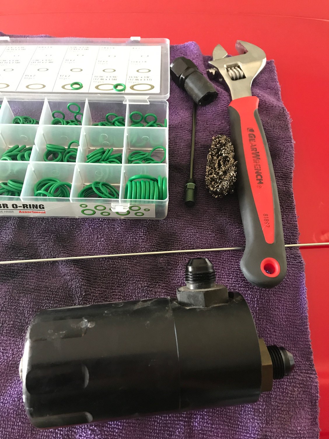

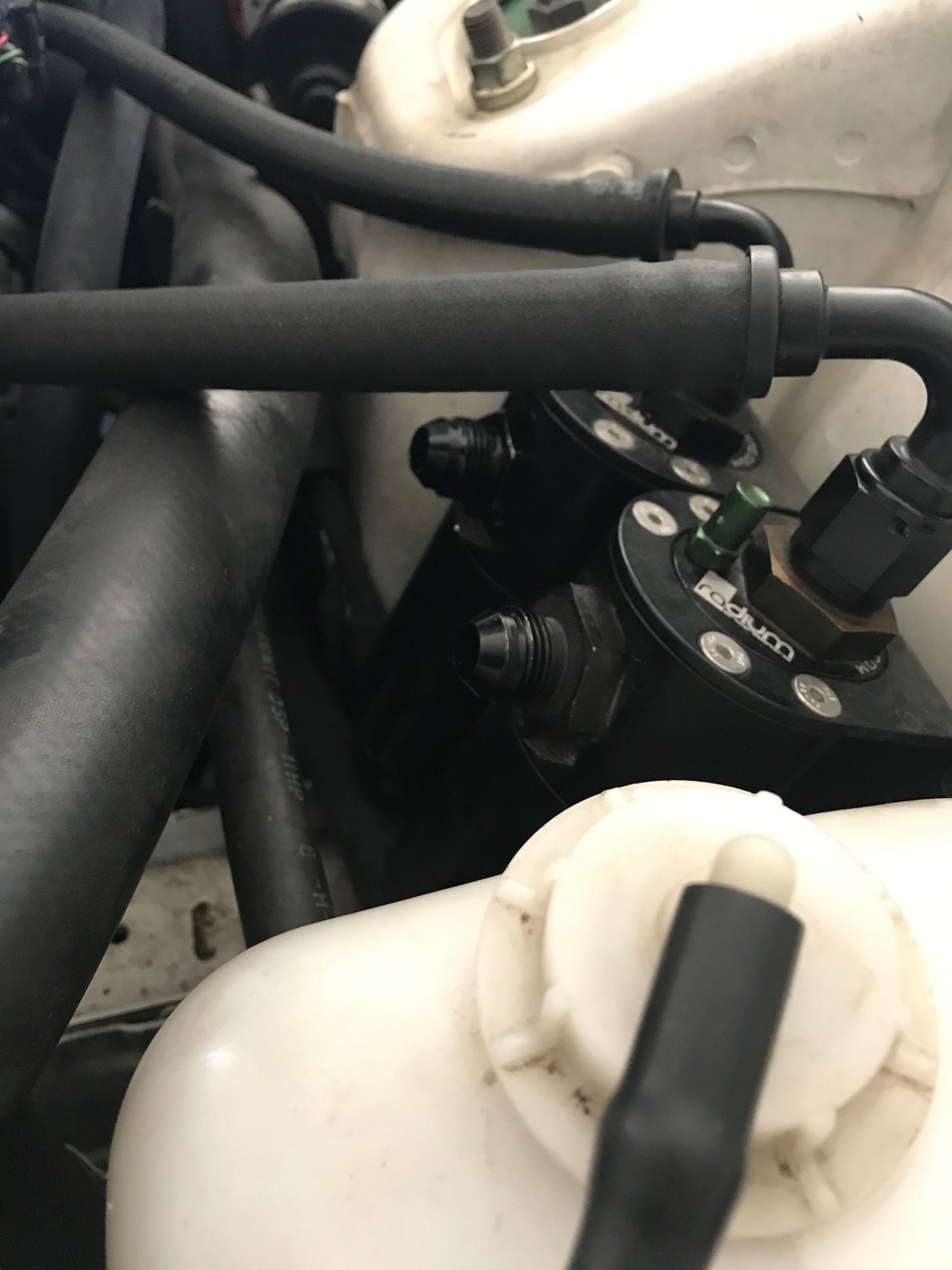

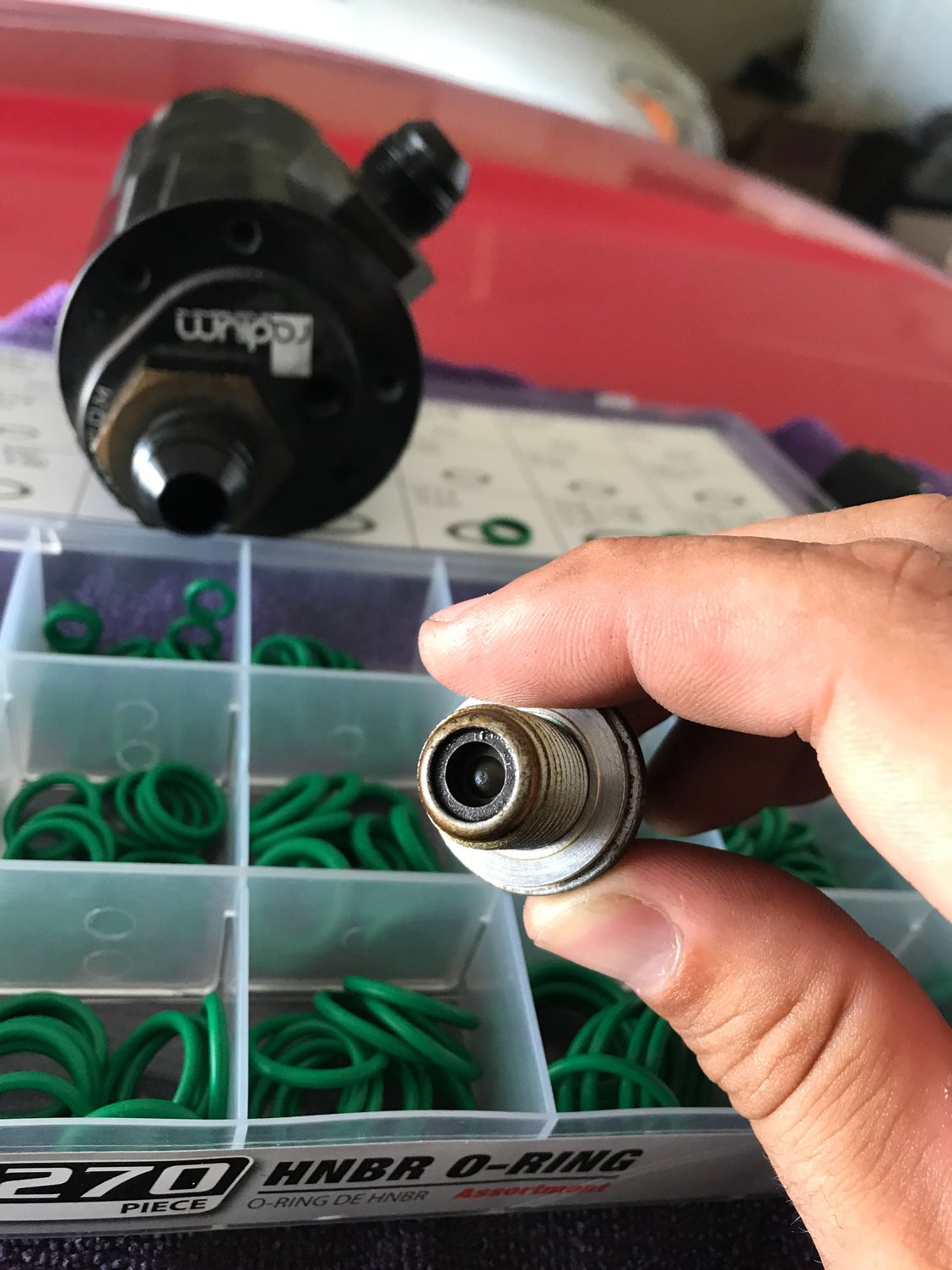

Swapped o rings
Removed baffle (steel wool)
Oem pcv
Oem pcv
Drilled out and cleaned
Extra size bit through it
Cleaned
