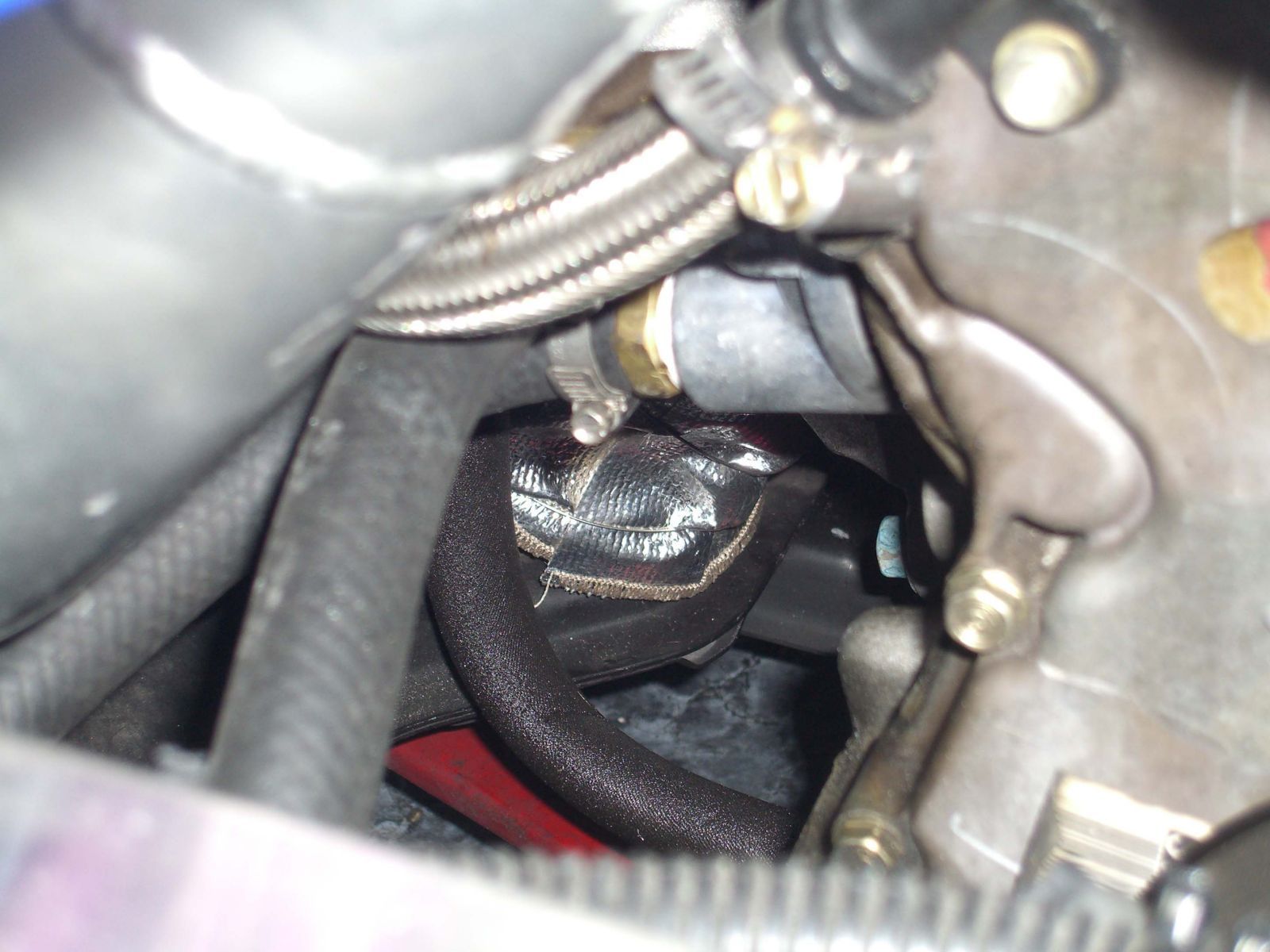

Hey guys! Nothing major, but i thought id share some issues that have come up due to heat.....Some of you know iv had my car in the shop. While there my mechanic noticed my fuse box was melting due to the heat coming from the turbo. Also he found the motor mount right below the turbo was shot. He fabbed a heat shield for the motor mount and wrapped it with a heat wrap. I also bought a ARC fuse box heat shield. Id recommend both to avoid a similar problem. Here are a couple of pics....
You cant see the fabbed shield, just the heat wrapping....
You cant see in the pics, but theres a piece of the HS that goes in front of the turbo

^^ I have that same ARC heatshield and we were planning on trying to use it with the InlinePRO kit and notch it out like that. Does it rattle at all?
Also, what exactly did your mech do to fab the heat shield for the motor mount?

The HS doesnt rattle at all...Def recommend...
He fabbed a piece of metal over the motor mount. Then wrapped it with the heat wrap. Next time its on the left i will take a pic. Between that and the fuse box HS he did an awesome job...
