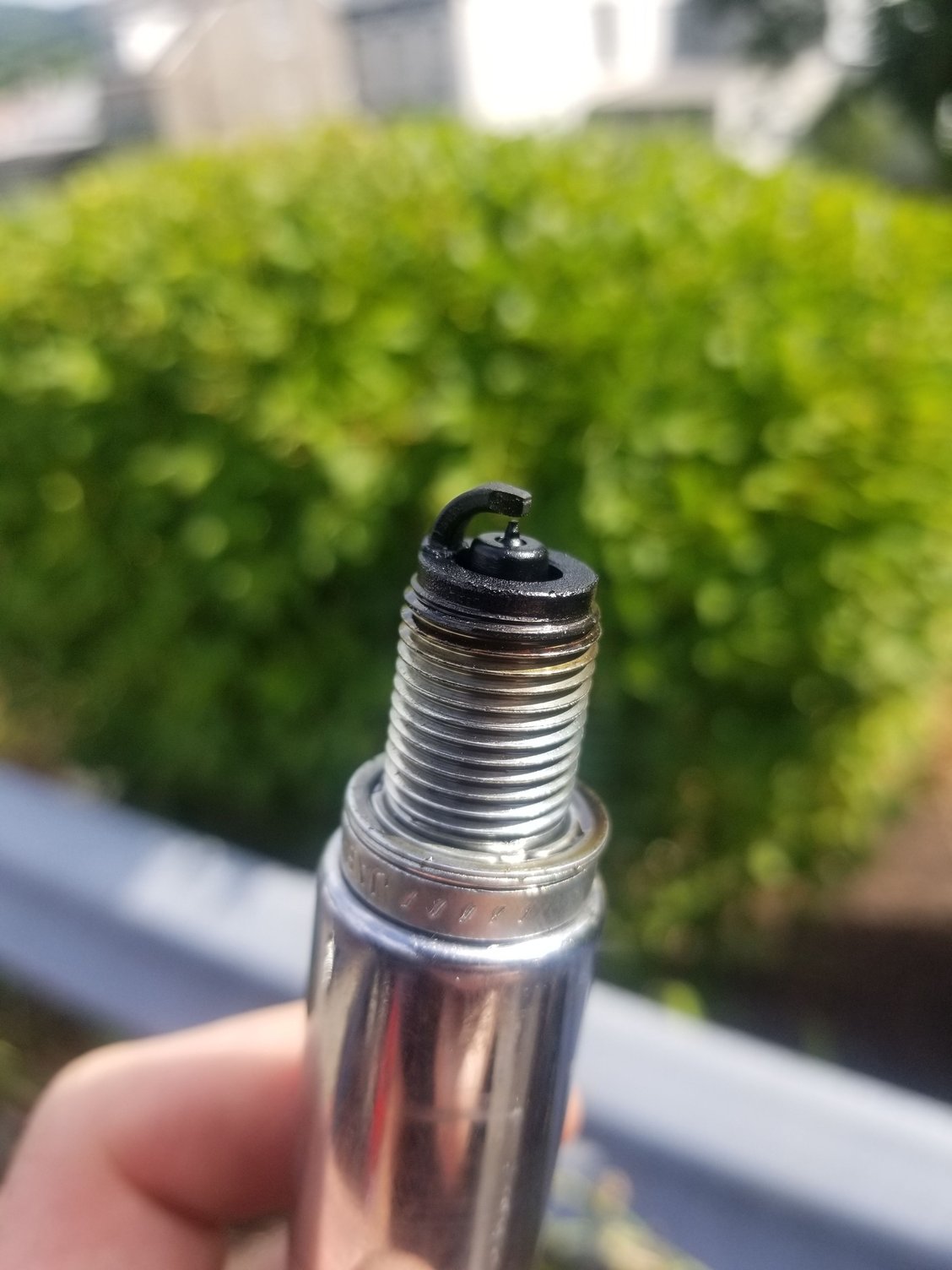

im getting a white/grey smoke from the exhaust on cold starts... its a fresh engine and im really hoping theres no trouble there. however, when i look down the spark plug holes in the morning, there is clearly something shiny on the pistons... could this be a lot of fuel? my spark plugs also look fuel/oil fouled. i was supposed to get in for the retune today but we wanted to wait to see what was causing the smoke. can anyone take a picture of what the top of the piston should look like under normal circumstances??

Valve seals is the first thing that comes to mind. Leaky ones will allow oil to slowly weep into the cylinders overnight, then it will smoke when started. Will also show up under traffic light conditions sometimes as well.

plugs and pistons look oil soaked. Puff of smoke could also be excess fuel. On one of my cars I get a puff of smoke every time it backfires and it is fuel related. Do a sniff test to the plugs. What spark plug gap are you running, it looks really tight.

yeah theyre at like 14thou.... its def. rich from the tune being a little bit off... its strange cause every cylinder looks exactly the same, like this. i feel like if it were rings or valve seals it would be on some cylinders, not all. is there any way for the intake manifold to cause this?? the gasket specifically

Well the fact that you did a fresh start with an off tune is a huge red flag. Your tuner should have given you at least a base map to get it running properly. Depending on how far the tuner is I would not drive it long distance. If its running as rich as it looks you will wear out the rings.
