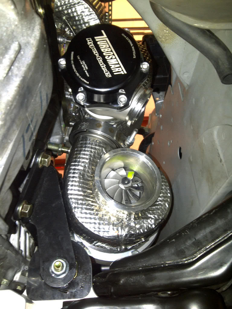

I think a bottom mount turbo like the Ptuning setup and SOS help with heat a lot. An oil cooler is a must. I think a larger radiator would also help with spal fans attached. There was a guy on the forums called Metros who tracked his ptuning car successfully and here is what he had to say about his setup:
From personal experience: The PTuning kit held up to track use beautifully. I ran the kit with stock radiator and Koyo radiator, as well as the setrab oil cooler that's part of their turbo set up. With stock radiator temperatures were fine upto around 75* ambient temperature. At that point if I continued to push the car the coolant temps would start to get hotter than I wanted (215-219*). I upgraded to the Koyo radiator and the temperatures stayed below 215*. I also learned that by leaving the heat on while tracking you could expect around a 10* difference consistently. Meaning if they peaked previously at 215 then they wouldn't go any higher than 205 while heat on. If you're running the greddy turbo kit then you're more or less out of luck. We had a local running the greddy kit that had upgraded radiator and oil cooler and still couldn't keep temperatures in check. The main problem being the greddy turbo only uses oil for cooling. His oil temps would spike up to 300 quickly and end up shortening his track time each session.

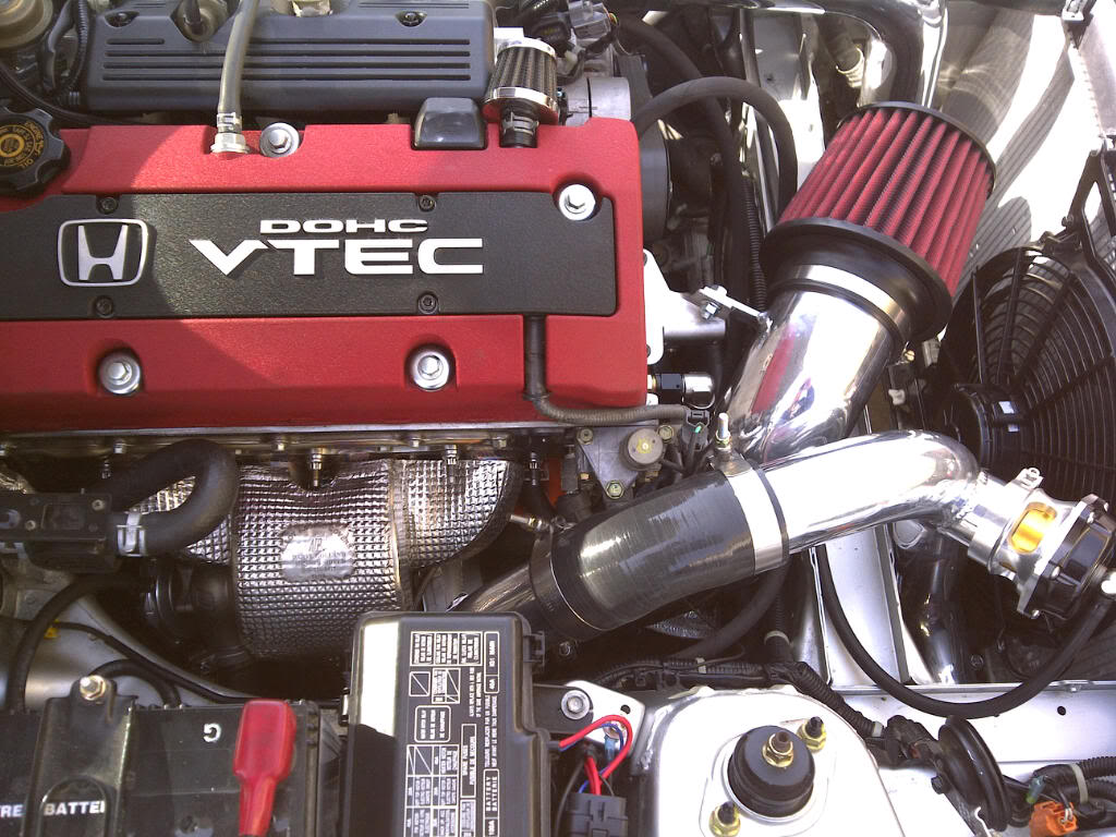

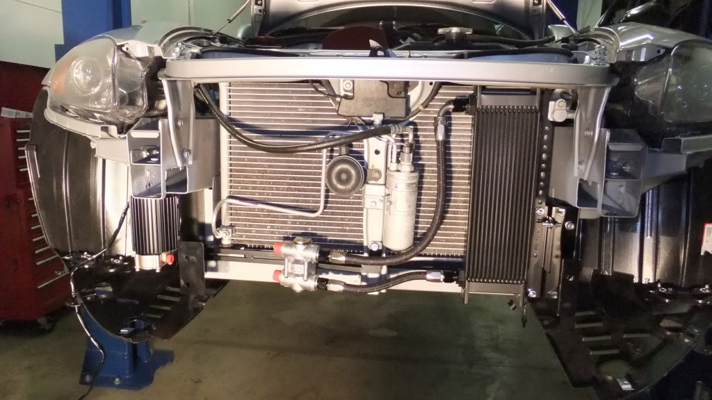

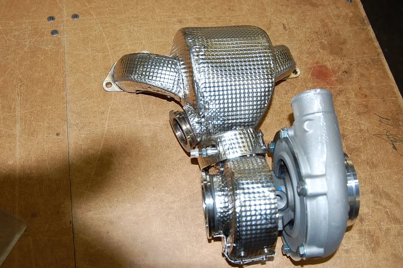

As everyone has mentioned heat management is a must. I don't know why people complain about spending money of heat shielding when they plan on tracking the car. Proper ATP Inconel shielding is a must IMO. It is expensive but a lot cheaper than a blown motor. The stuff is built proof and there is a reason high end cars use the stuff...it works!
Some pics of my previous setup:
