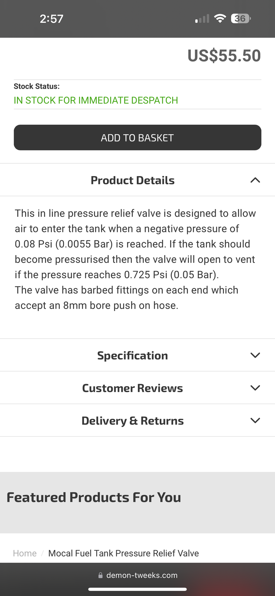

So I’ve got a question about the valve. Mocal says that the valve will open either way depending on the amount of pressure being exerted on it.
Does this mean that I can just cap off one of the hoses and use only one of them as both the breather and the vent? Sorry in advance if this is a stupid question.
I can confirm that the valve opens either way. I tried it with my mouth with I first got it to see how much pressure it would take to open the valve and I was able to get it to open both directions. I don't think that you want to cap the other line though. I have seen/heard people having issues properly filling the tank with one or both of the lines capped. I believe the larger line is for that or to let air into the tank when necessary. Just buy the recommend filter and dremmel out some of the rubber like I did to get it to fit over the OEM plastic connector.
