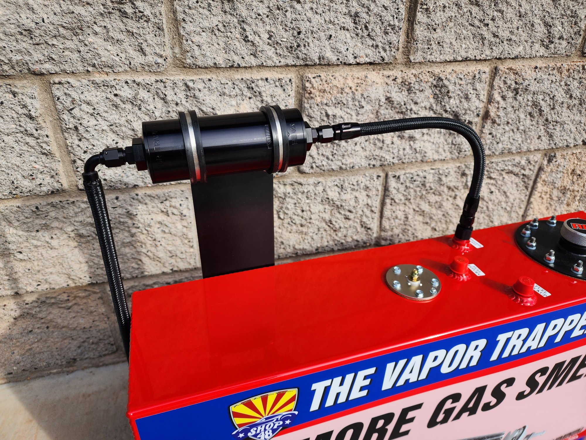

The new Vapor Trapper by shop48.co is a really good solution to the removal of the evap system when you still want to end the gas smell the comes from the removal of the oem system. Letting the vent lines stay open immediately allows the gas smell to be obnoxious. Look into the Vapor Trapper. It's easy to install and super high quality!

My car has been set up with the recommend configuration in this thread for a while. It works well, but on hot days the garage does smell like gas, and you can absolutely hear the pressure value open and let air through. It's a low humming noise.
My car's been up and running for a while, and was recently tuned so I have been driving it quite a bit. I can smell the gas at stop lights and in the garage when it's hot outside. I spoke with a few other people who also smelt the gas and added some sort of charcoal canister to help with that issue. Over the weekend I searched though google and that vapor canister that was posted above popped up. I noticed they were local so I swung by with the car to talk to them about my fuel evap set up, and if the canister would work. It seem like it's the exact thing I have been looking for.
The current plan is to figure out where to mount it, and what fittings I'll need to make it fit. Once it's installed I'll report back on if it eliminated the fuel smell.

Everything they posted above isn't part of the set up. Most of that is the fuel cell. It's just the circular chamber that's being used to absorb the vapors. Like the OEM unit this will collect vapors and saturate the charcoal over time. The benefit here is that the unit is serviceable. You just unscrew one side of it empty the used charcoal and replace it with new material. For me this means that once I solve the problem it's solved permanently. I don't have to go buy another canister when this one is saturated because I can just empty and fill this and put it back into place. I should have an update for everyone in a few days.

Basically just a billet charcoal canister that you can service. My plan is to keep all of the set up that's outlined in this thread, and have the pressure relieve valve plumbed to vent into this canister, then route the canister vent to somewhere inconspicuous. I'm really hoping that this takes car of the fuel smells.
