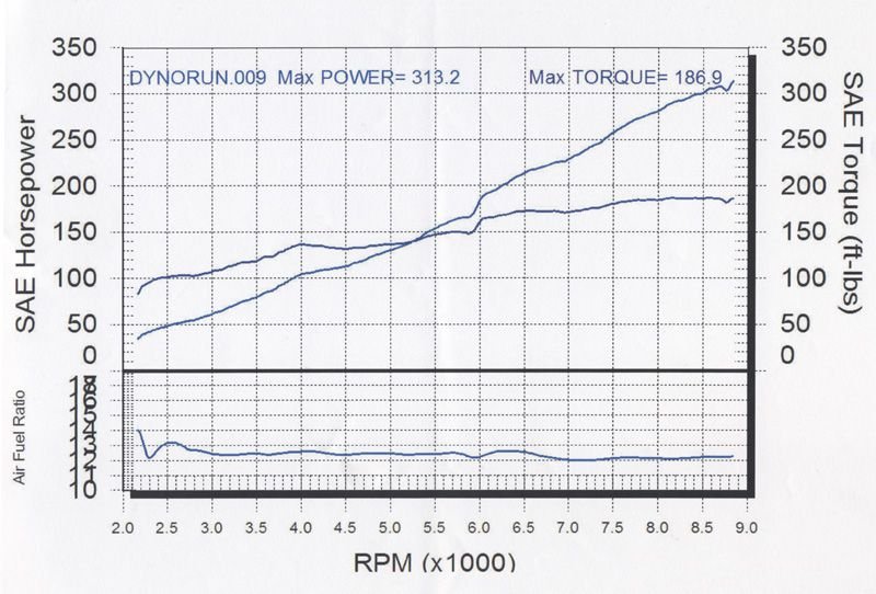

The guy who did my dyno was saying that Vortech SC on a S2000 have a tendency to be lean at VTEC crossover then tend to rich again after hitting 8200 all the way to 9000. And he's also saying he heard a little bit of detonation. I need help guys . What are your opinions? He's saying about SFMU and AEM APR and he's saying...we have to fix that lean or it could blow my engine. Anyway I have a 271HP on Mustang Dyno at 8200 RPM. That's the best after three runs. I think it is sucks......So what's that at the crank 352 HP I think it's a keep but I'm serious guys....I need some very good suggestions from you to fix this lean. Thanks

How lean are we talking about here? Can you put up a trace to show us?
Vortech does advertise (at least they used to) an additional 108 HP at the crank, so this puts it at about 348. Also, a Mustang dyno has not shown to be the most "satisfying" way to measure things.

But both Vortech and Comptech tend to run lean out of the box. the Comptech version is easier to adjust a/f since they come with an adjustable Fmu. But when i finished installing it, i took it straight to Shawn at Church Automotive, and it was running lean at about 15:1 hp until the vtec change over it was running about 14:1 hp was about 285hp initially, I was told he saw that quite often lean out of the box, with those superchargers. After many attempts and even using the Vortech Adj Super FMU, vafc, emanage, i've found that the standalone was my best option. With the standalone, i'm prolonging the life of my motor.
I've found the numerous amounts of money i've spent on bandaid fixes just wasn't working for me. and the only thing i have on my car is 550inj now, i'm still using the stock pulley.
I'd much rather have less hp and safe a/f than more hp with dentonation and possibly blowing my motor.
