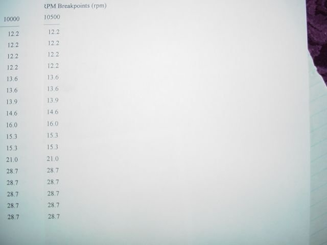

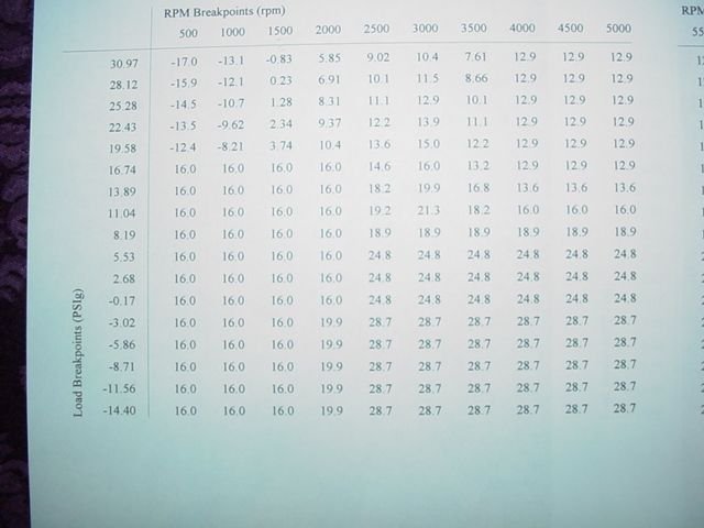

I Thank you for your response but, I do not have a laptop yet! I am at the mercy of the tuner until I get one - is there any way of looking at my basemap to see it? I have that on my computer with the AEM Software!!!
I took the liberty of looking at my timing tables and printed then took a pic, Does this help ?
Old Sep 10, 2005 | 07:13 PM
honda9krpm's Avatar
Posts: 4,857
From: Gold Coast
looks like around 13.6
fairly conservative tune
