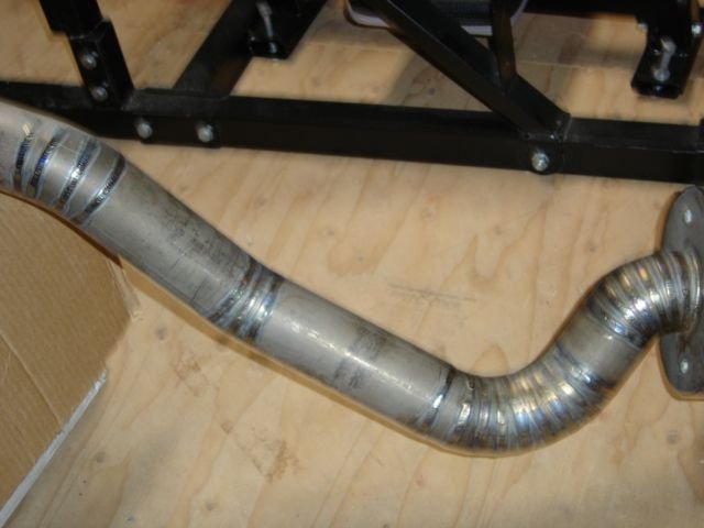

The 3" Exhaust Systems are here and in stock.
For SCed and Turbo they make more HP gains.
You will see ~20-22HP gains @ 10-12 psi SCed.
A nicely done header will make a huge difference up top. The dyno runs in the above graph were with the stock header.
With a turbo you will see 25-39HP gains depending on boost.
