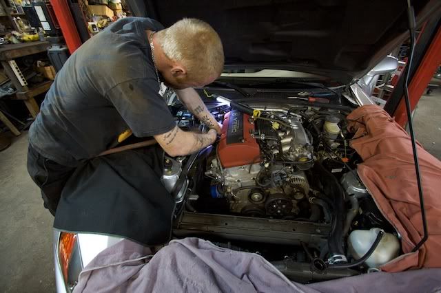

Hello, This is Brian Barbour and I'm with AUTOMOTIVE PERFORMANCE in Fayetteville NC, I bought a 02 S2000 that is extremely Clean that had what appears to have a Rod Knock. Well My Boss that runs the place has been an Enginge Builder for 40y. So we gonna fix that Honda...and then some. As far as My Boss, Tony Raimondo who is very well know in our community has been turbo charging 510 Datsuns in the early 70's to building 700+ cubic inch Big Block Sonny engines. So I'am very excited to do this build. Especially having Tony on my side.

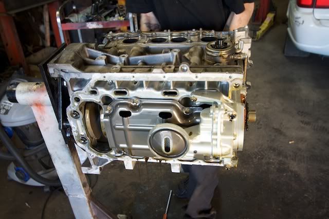

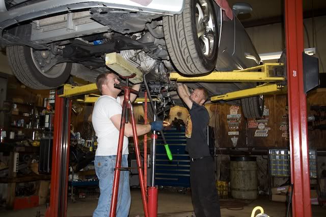

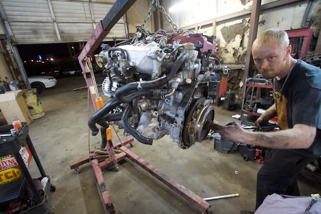

So far it has been 3 days since I took Delivery on the Vehicle and Have pulled the Engine and stripped the Engine to a long block.
Josh & Josh and me taking the Pic, getting ready to have some Fun!

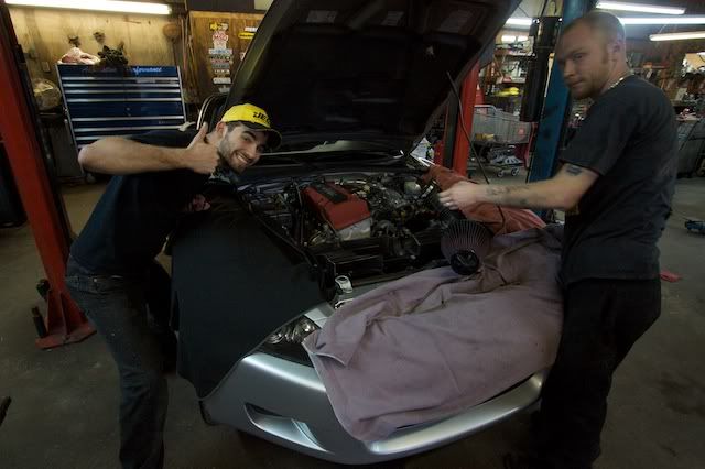

Josh Removing The Header
Should have used the Torches and that thing would have been out in 20min.

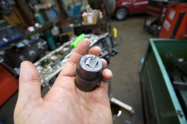

Has anyone tried to remove the Harmonic Balancer bolt yet well, First I tried my 3/8 Snap-on Air Gun, then My Matco 1/2" Air Gun, then I used a 3/4" Breaker Bar that is
3 1/2' long and Broke my cornwell 3/4' to 1/2' adapter socket, Finally used an 3/4" Impact Gun, came off like charm with the 3/4" impact.

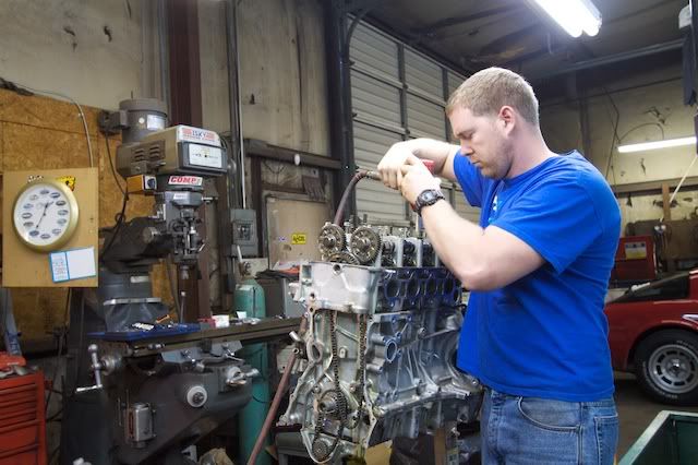

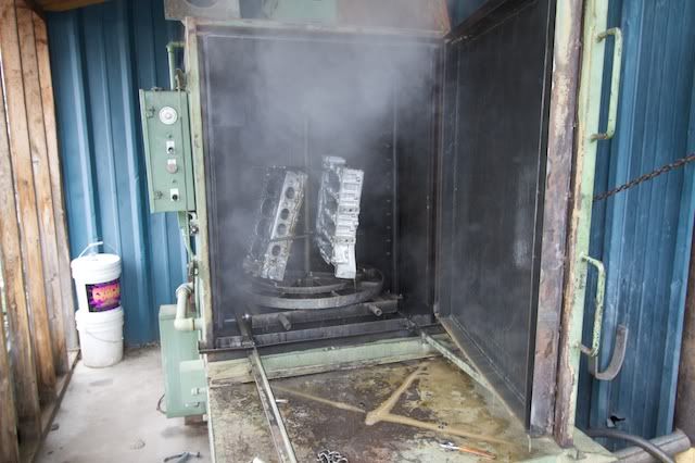

Saturday, I went to the shop by myself and completely disassemble the engine and cyl head and ran everything through the VAT. Phase 1 is Complete!
Enjoy the Pic's

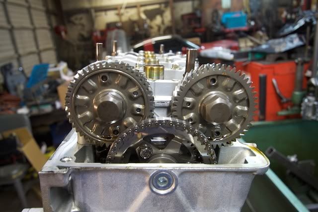

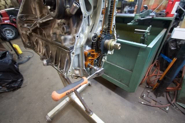

Starting to Remove the Timing Chains!
Things go Faster with Air tools!

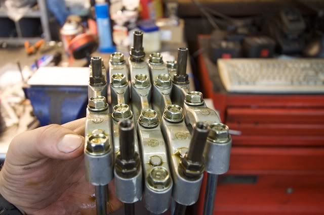

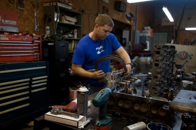

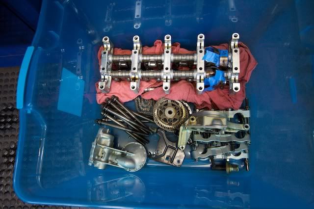

It is Best to keep Valve-train Parts together so there will not be any confusion when it comes to re-assemble it, Did that mistake once!

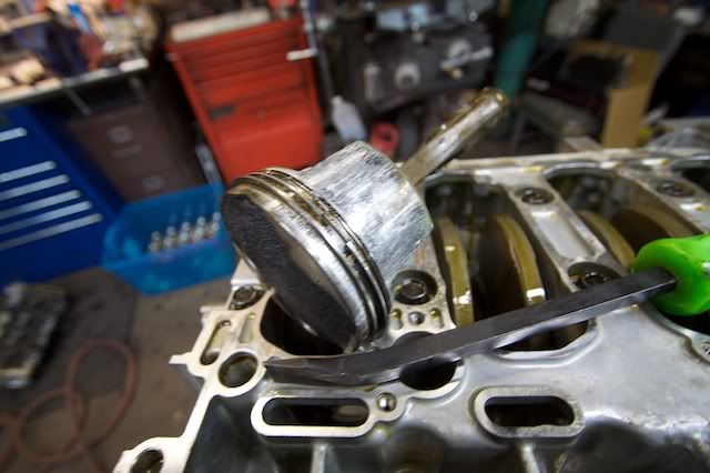

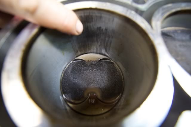

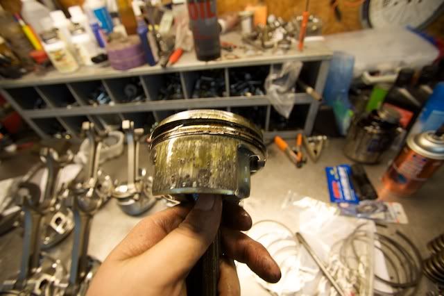

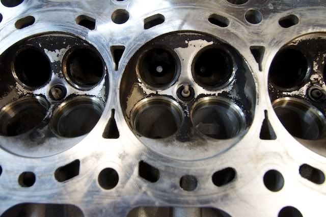

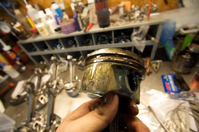

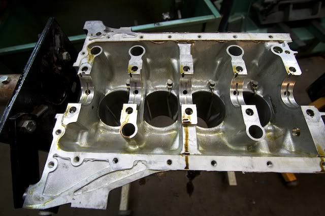

OUCH Cylinder Walls! This engine starved for oil once and ate up the Cyl. Walls, this motor had major Piston Slap, almost sounded like a Rod Knock

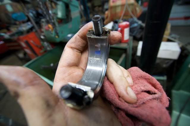

Rod Bearings have minimal wear
My Bosses Snap-on Adapter snapped off when we tried to remove the Harmonic Balancer Bolt and thats 3/4" Drive

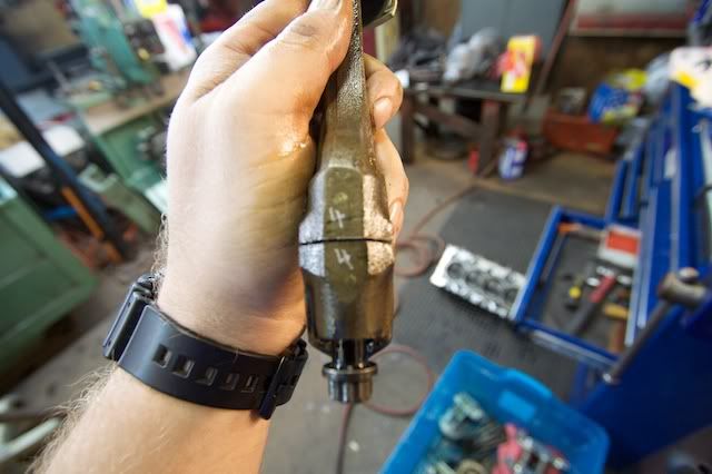

I marked the Rods with a dremel

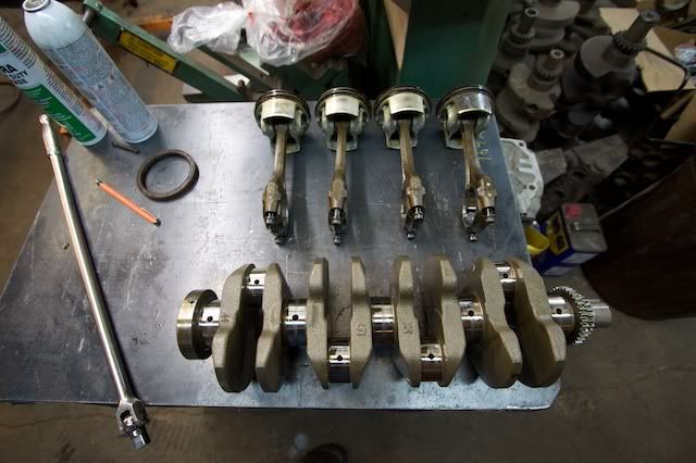

Now we are Getting somewhere! Crankshaft...Tadda
95K Miles and this is Living Proof that Synthetics work...No Sludge! BTW we are all great supporters of AMS OIL

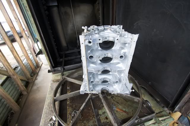

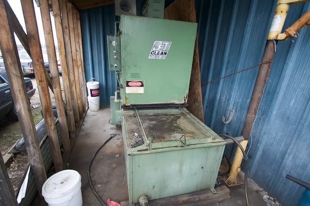

Here is our Cleaner
Everything will have to be Cleaned again after Sleeving, Boring and Honing
Keeping Everything Organized is the Key

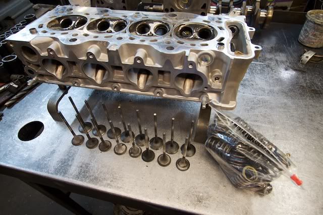

Taking the Head Apart
Keep a Magnet Handy, Keepers Love to Fly Away

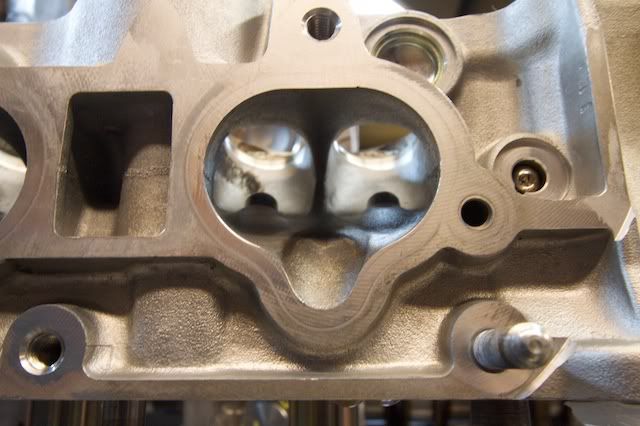

Nice ports from the Factory, anymore porting and you are loosing power, just leave it alone!

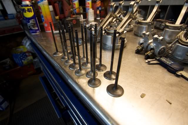

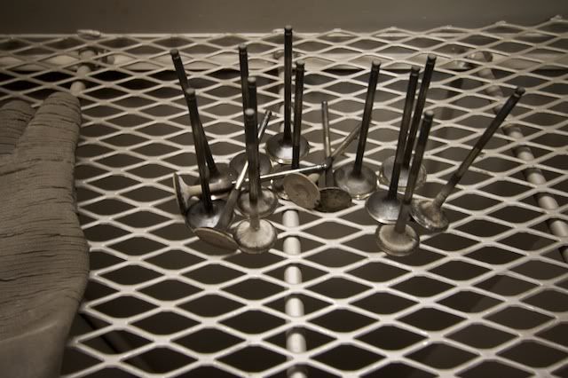

Valves being Beat Blasted

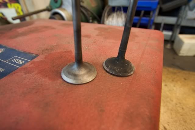

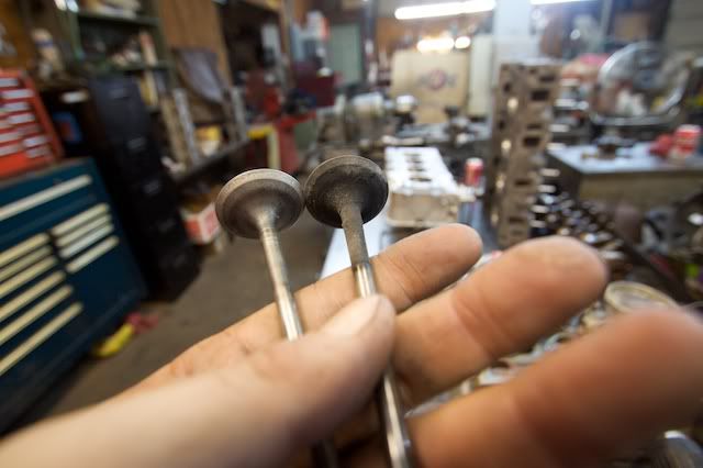

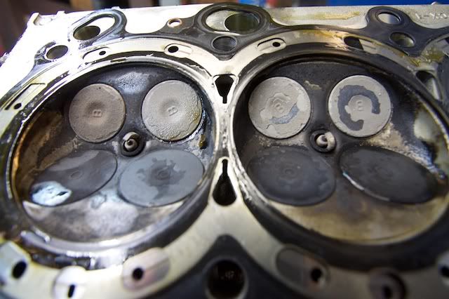

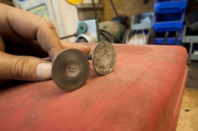

Clean Exhaust Valve v.s. 95K Dirty Valve
All Clean now
