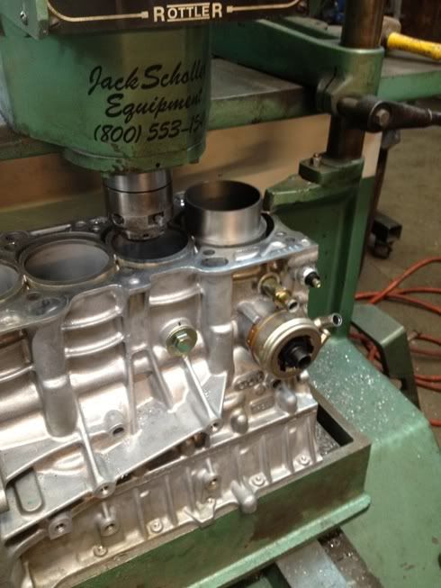

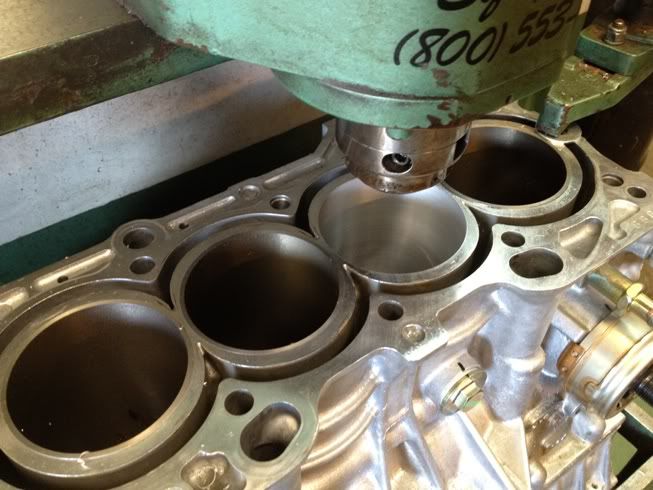

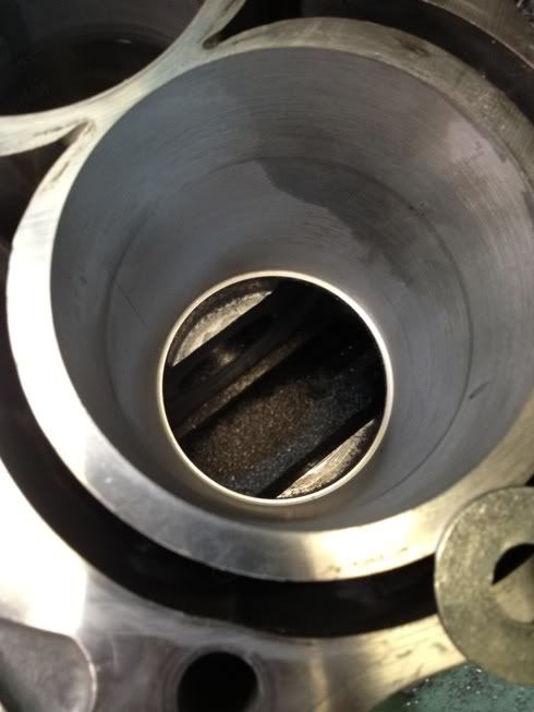

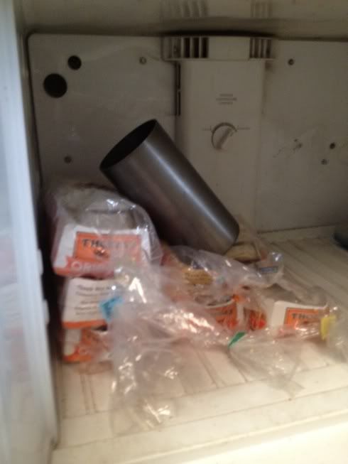

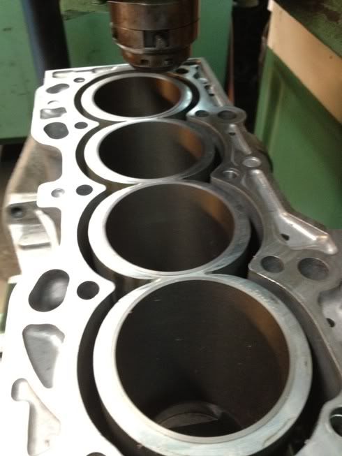

Ok it has been a two weeks or so and we made some progress, yesterday we finished the block with the Steel sleeve install. It was very Labor intensive and my boss was working on my Block only on Saturday's since Customers stuff has priority. Getting the Sleeve in, everything had to be right on, without makin any mistakes. The Sleeves are 2mm Sleeves with a 0.0015" Press fit
ALL FOUR SLEEVES ARE INSTALLED

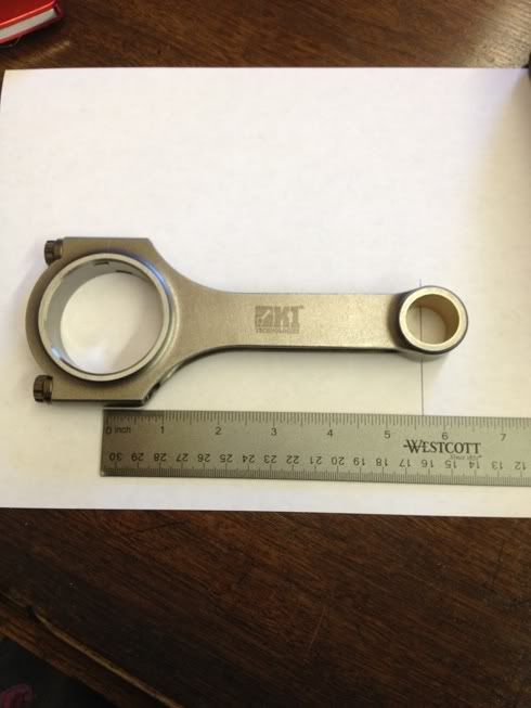

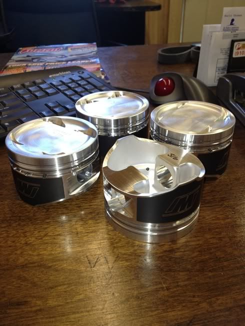

Here Are Some parts I will be Using...
BTW, after comparing stock Rod and Piston, The H-Beam K1 Rod and Wiseco Piston is 113g lighter than stock per set, so I'm loosing almost a pound in rotating mass but probably will gain some with the K24 Crank

Are those K24 / F20c rods or K24 / H22 ?
they don't seem to be @ 5.63" like stated on K1 website for ref#HH5630AEGB4 Honda Honda S2000/K24 Conversion Rod but the correct 145.5mm/5.73 " lenght to use those rods with F20c (30mm compression height) pistons, does the small end is the correct 23mm pin and not 22 like the k1 website states ?
Thanks, that would free up the headache of custom rods.

Originally Posted by Bigfootexpert
These are called F20/K24 Conversion Rods and are designed with the Wiseco Pistons. You will still have to modify the K24 Crank and Ballance everything. As soon as you use aftermarket Rods and Pistons you change the BOB weight and the whole assembly will need to be ballanced again. I'm sure some people skip that step and probably get away with it but I would not recomend it.
+1 Esp in a motor such as the F20/22 and now the 24. These engines need to rev to make power and have such tight tolerances, differences of just a few grams coupled to 8k+ is a lot of resistance in the spinning motion and therefore loss in power. Ultimately, it can lead to uneven bearing wear and inevitably, scar up your bearing journals. Spend the extra couple hundred to get everything balanced and have peace of mind.

Ok, made some progress. The block is completely machined and clearanced for the stroker assembly. The Block is Decked to Zero Deck which is perfect since we will be using a COMETIC .045" or 1.14mm thick HG. In the following pics, It shows where we had to notch the Pistons for the oilers, wanna make sure everything stays lubricated and cool. We are also done with the Pre-assembly and now, everything can be taken apart so we can send off the Crankshaft to be balanced. Two days Ago, I ordered a new ATI Balancer, XXR 521 Wheels and tires. Also have some 1000cc Deatschwerks Injectors and 400GPH pump coming, so if everything goes well, I should be at the dyno in 4 Weeks. I tell you, all the machining and pre-fit and pre-assembly takes the most amount of time than any other aspect of this build.
My Buddy Scott helping out tremendous with his machining skills
