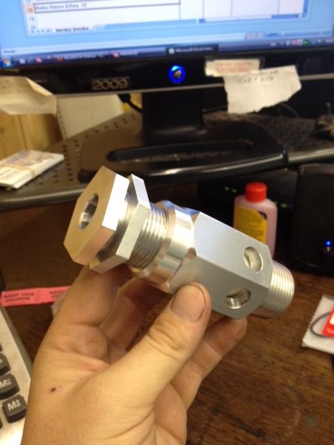

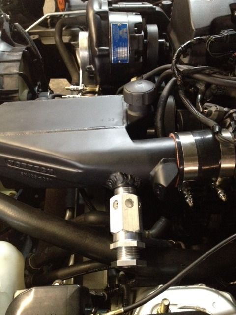

Not much of an Update but I'm very Close, going to get it tuned friday the 29th at National Speed in Wilmington NC. I have a 3.33 Pulley and will set the redline at 7800 just to be safe. I also order me a BLV Boost Limiter Valve AKA Check Valve which works like a Manual waste gate just too keep things in control and safe. Pulley Size seems always to be a mystery so this BLV will help me controling the boost in case I make to much or have excessive Belt slippage but then again, maybe I will need an even smaller one. I don't want to speculate but 450whp is the goal, Friday will tell.
Everyone at work was fascinated with the BLV and had to play with it

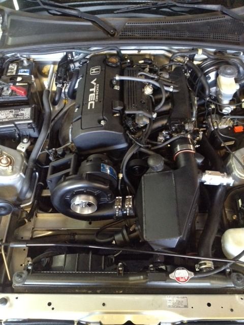

9.5 C/R, 93 Octane 3.33" Pulley. At 7800-7900rpm My guess is anywhere between 14-19psi, the supercharger will turn 51K rpms at 8000, so if you convert that into CFM it will be almost maxed out. So I'm thinking at least 15psi. It is a V-2 Vortech Blower
Not sure Which Dyno National Speed Uses, I hope it is not an AWD Dyno, since it takes more power to turn those drums. but my main goal is to tune it right and safe, I'm not chasing HP Numbers, I want good A/F Ratio and good Idle, since I plan on driving this thing at least 3-days a week.

She is All Tuned, She Made 430whp @ 8000RPM and 12psi at 98F Ambient Temp. will make more at lower temps.
275ft.lbs, She Handles Like a Ferrari and Accelerates like Z06
