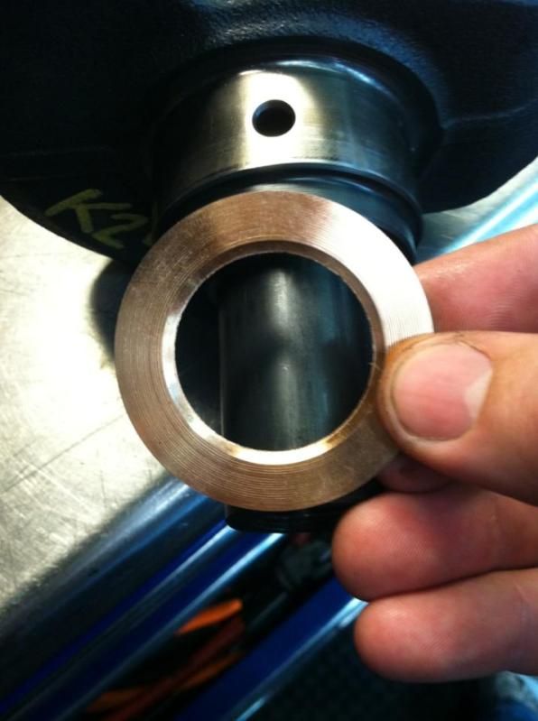

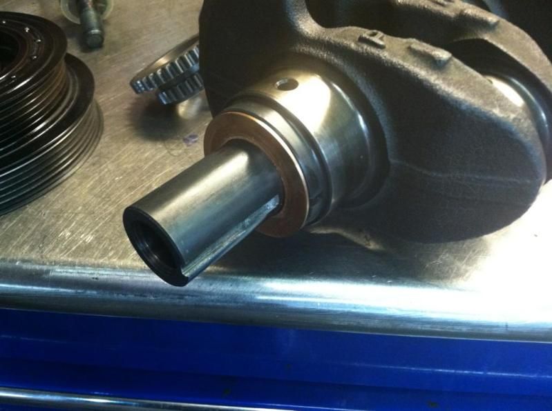

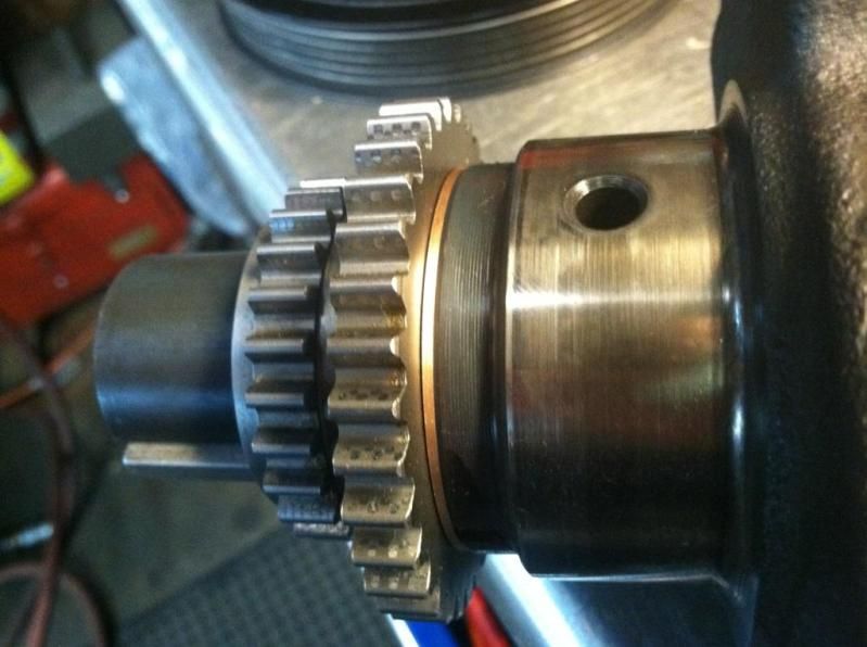

Hey Guys, Glad to see, people are interested, well Today we send off the Crank to another machine shop for balancing, Usually a 4Cyl like the F20 does not require traditional Balancing, like a V6 or V8 Engine but it will get Balanced Dynamically. But right before we send it off, we had to space out the Timing gear perfectly, so the bottom gear is true to the upper gears and also for the correct position of the Harmonic Balancer. Once I receive the Crank Back...It's Assembly Time!
Scott deserves all the credit for making this awesome copper Spacer from round stock copper.

Scott deserves all the credit for making this awesome .042" copper Spacer from round stock copper.
Hi,
building also F24 in Poland
Why coper spacer?
Old May 18, 2012 | 03:52 AM

Hi,
Why coper spacer?
I believe this is to align the top and bottom timing chain gears.

Sure, I now that.
I'm asking why material for spacer is coper?
