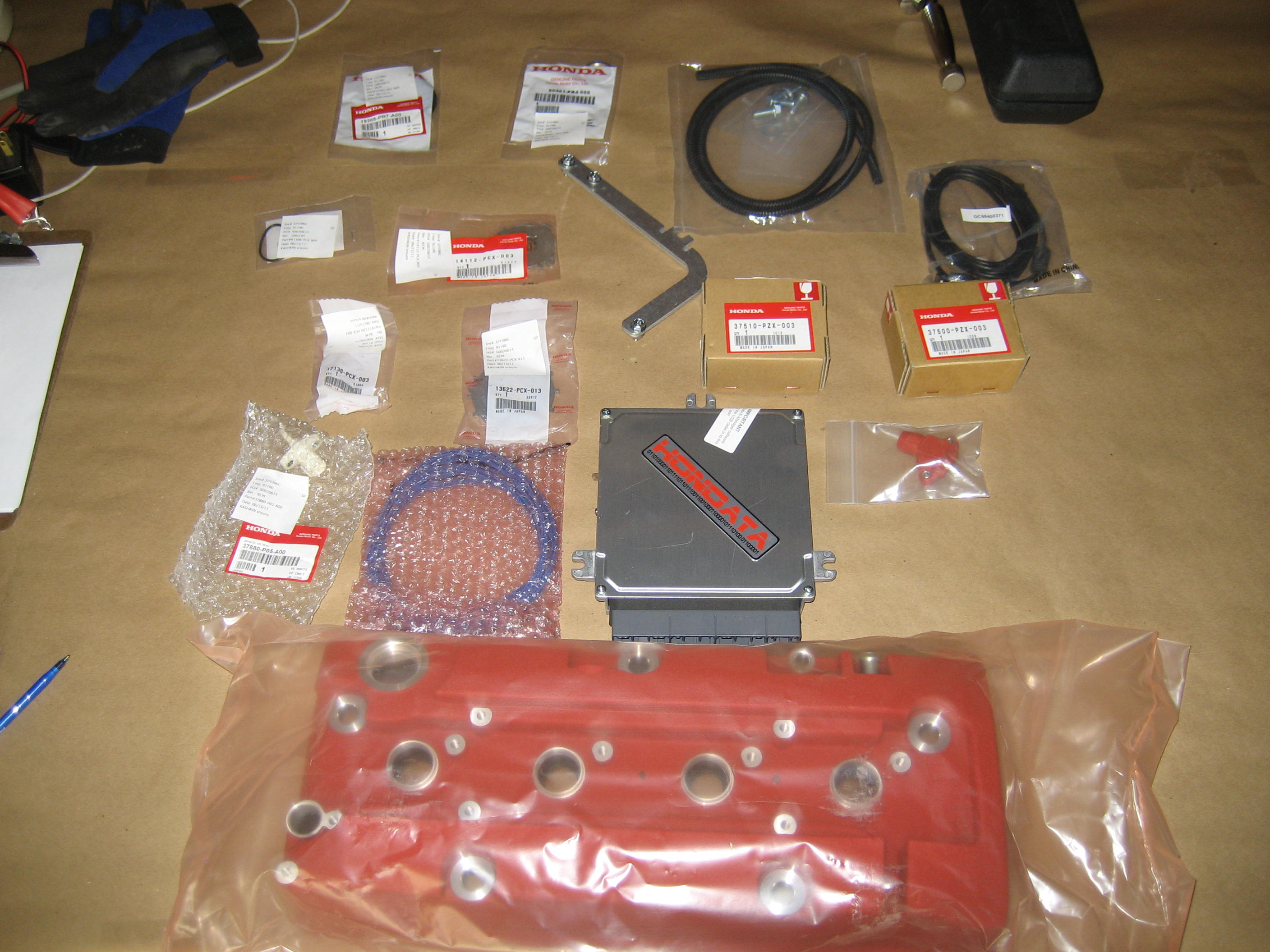

I am going to install the Kpro first.

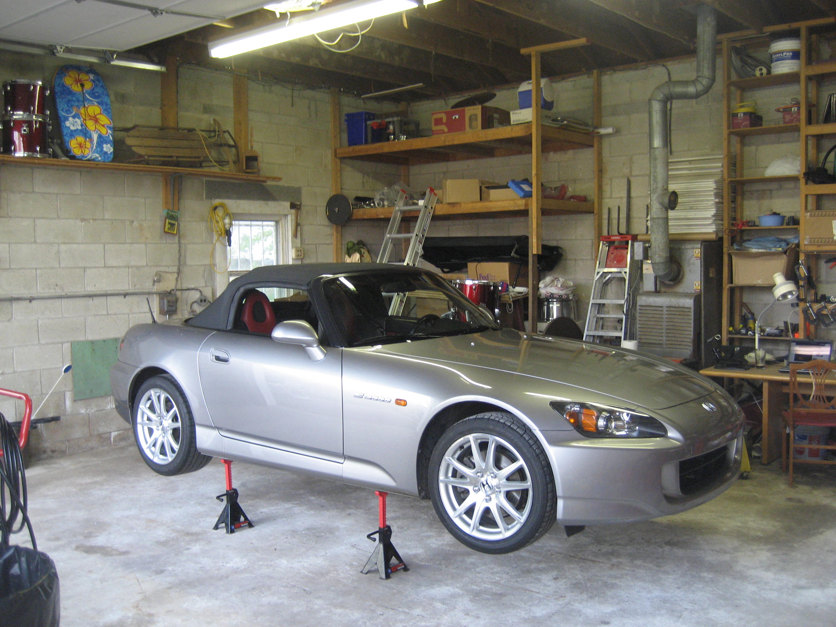

Here are some pics:
[attachment=19201:Post 2.JPG]
[attachment=19202:Post 1.JPG]
[attachment=19203:Post 3.JPG]
[attachment=19204:Post 5.JPG]
[attachment=19205:Post 4.JPG]
