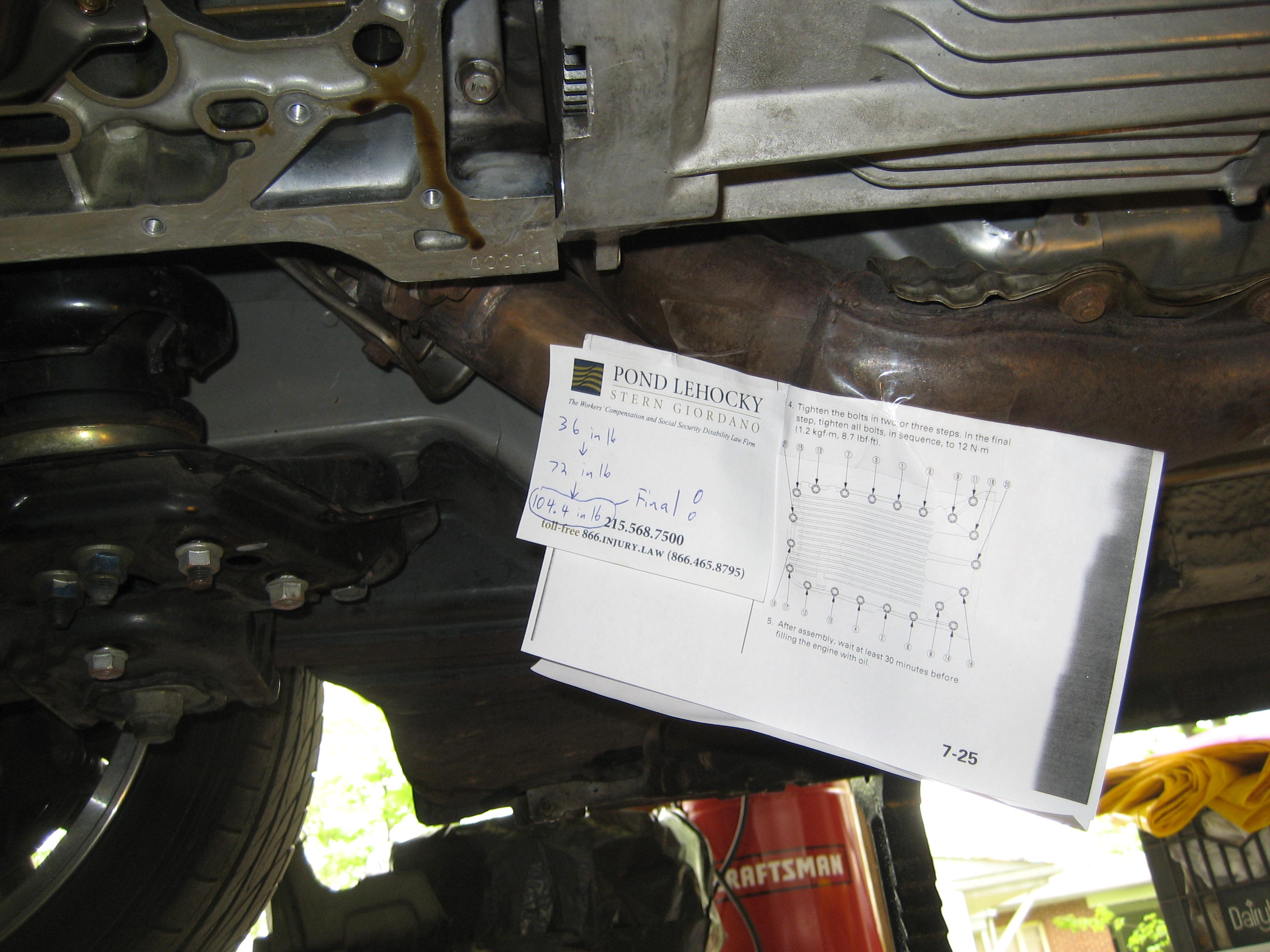

Had torque pattern handy before installing oil pan.
[attachment=19793:IMG_6792.JPG]
