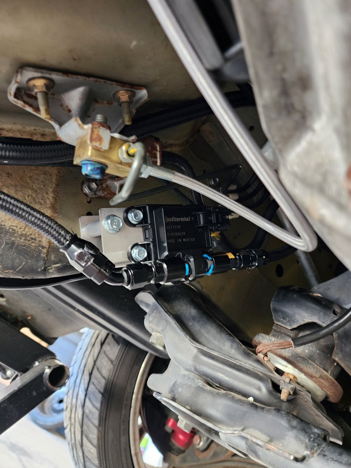

Replaced the feed line with the radium 8an line. I hope to never do that again. Fitting the 8AN line onto the fuel pump hangar was a pain and routing the line down the tank required removing the white clip that holds the lines to the tank. Otherwise the install was not hard. Only took about an hour.

I went ahead and added a flex fuel sensor to the car this weekend. Highly recommend that you do this when running the line initially versus waiting till later like I did. Again wasn't hard but I didn't enjoy making fittings on my back under the car. Unfortunately my AN wrenches broke and I had to use steel wrenches that marred up the fittings.
Nice! You put it on the return side, correct?

Correct it's on the return side. I went with the SOS kit, which I realize is more pricey and includes stuff I didn't need. But it also includes the metal mounting bracket, which I did want. As long as it works, it's a one time expense.
