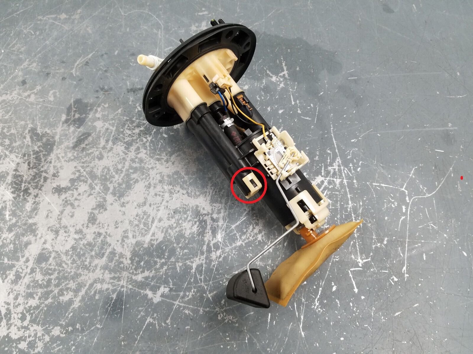

Okay. Did you see that it came with a green O-ring? It doesn't come installed, and omitting it will cause issues with fuel pressure. It goes under the white clip on the black portion of the carrier. Ask me how I know...
Old Apr 2, 2024 | 04:52 AM
  #77
Mobias's Avatar
Joined: Feb 2024
Posts: 60
Likes: 18
Mine did not come with a green oring. I just double-checked the bag of parts it came with and there is no oring. The bag is still sealed, so it definitely didn't fall out. When I go to swap the pump, I will pull that part and double check for an oring.
Interesting... I will have to check my bag for this, I dont think it came with any extra O rings and I certainly didnt check that little white part for any reason. I just installed and went on. I dont have fuel pressure issues so?
