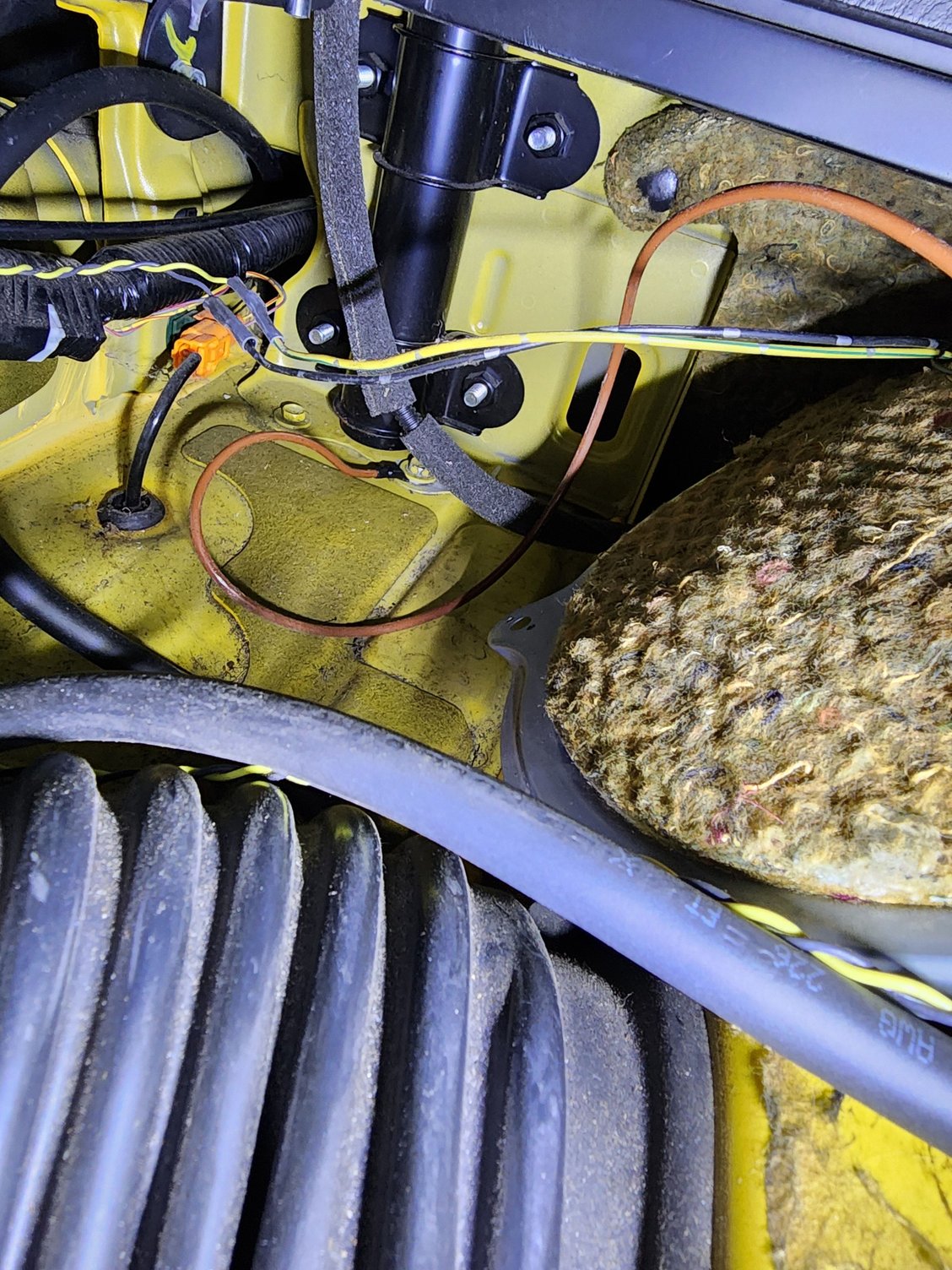

On the driver side by the bottom of the metal loop there is a bolt that goes into the body and frame. I'll try to get a picture of it later. It's kind of a pain in the ass to reach, but you can get to it with a little stretching.

Picture of the location I used .
Appreciate you showing that.
