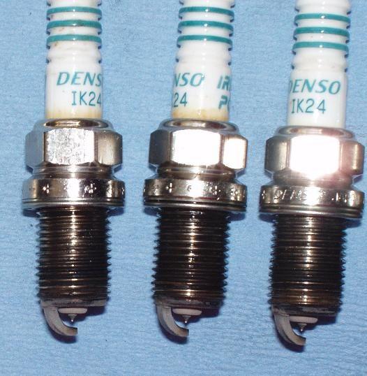

Just thought I'd throw in an update.
My SC has about 6,000 miles on it nearly all of them with IK24s. Reading this thread I pulled them and swapped them out for NGK Copper 7173s. My car has been runnning fine. I've always been on the lean side (as evidenced by my A/F at Comptech's dyno and previous inspection of the plugs).
Below is a pic of my IK24s. From left to right, they are in order from front to back in the car (#4 isn't shown, it looks just like #3 on the far right). #1 and #2 have some thermal 'effect' on the insulator similar to the stock plugs when I pulled them after going SC. I detected no loosening of the ceramic. Again, these only have ~6,000 miles on them. Not making any conclusions here, just wanting to share my findings.

Just guessing and not being a pro or anything, but shouldn't those tips be burning a bit whiter? And I see a buildup on the ceramic of two of them.

The discoloration on the outer ceramic seen in the picture of 3 plugs is only cosmetic and not indicative of problems.
When your FI engine eats a plug, IMHO suspect the tune parameters (timing, mixture, octane, etc) were not quite correct
and pre-ignition was the cause. Don't blame the plug.
